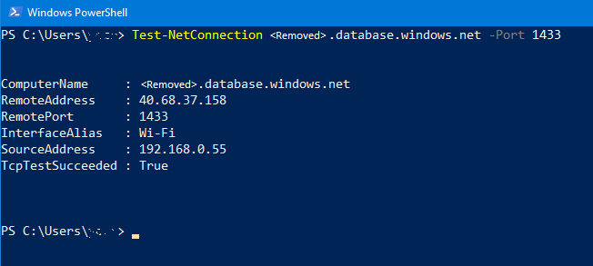

    To know the Ip address for Managed Instance Public Endpoint please use the following PowerShell command and your endpoint FQDN with TCP port 3342
    Below an example but using a different port
    Remember to use port 3342 instead.
    In addition, you can download and use a tool named psping with the endpoint FQDN and TCP port 3342 as parameters, similar to the Test-NetConnection command.
