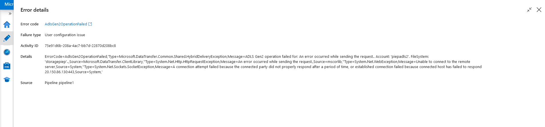

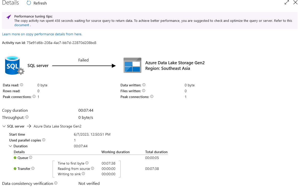

Hi, I had set up Self Hosted Integration Runtime on my on-premise VM with azure cloud using Azure Data Factory. The connection is already been tested and checked green on both integration runtime and linked services. My goal is to be able to copy data from DB on-premise (as table data source) to either ADLS Gen 2 or SQL Server in Azure (as data Sink). The connection between services also had been tested without errors, but when I try to debug the pipeline of copy data between those two locations, it still shown error.
I've been trying to looked up into the log, but its confusing since the error shows on Azure Services even though there is no trace of read data when I debug the pipeline in Azure Data Factory.
Attached the screenshot of the error, thank you!

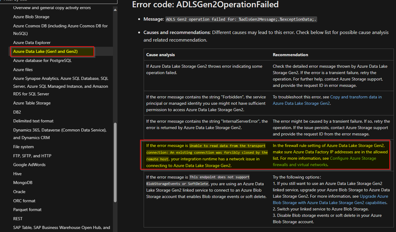

    Based on above confirmation and looking at the error message, my understanding is that the issue could be related to ADLS Gen2 networking.

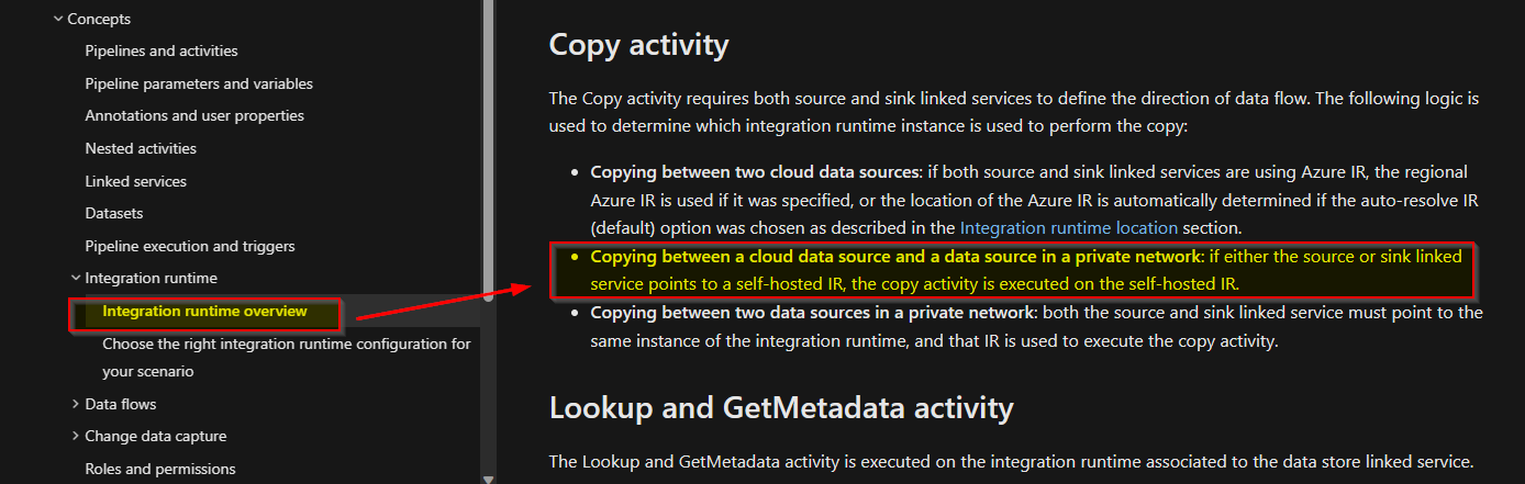

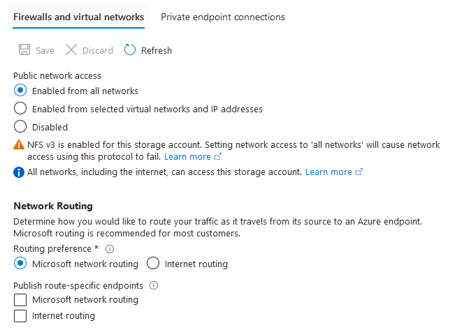

    In order validate that, please check if your ADLS Gen2 is firewall enabled. If that is the case, then you will have to whitelist your SHIR hosted IP address to have access to your ADLS Gen2. You may ask that you are using Azure IR for ADLS Gen2 connection but what is the need to whitelist SHIR IP address. The reason is that when either of the source or sink linked service points to a self-hosted IR, the copy activity is executed on the self-hosted IR even though one of the data store is connected to Azure IR. Hence if you have any firewall restrictions, then you will have to whitelist SHIR IP address so that it is allowed to acccess to data store.
    This has been called our here: ADF - Determining which IR to useUser's image

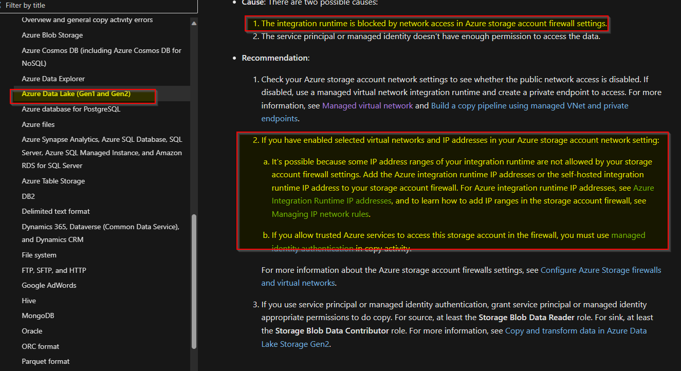

    Please refer to this troubleshooting guide which has related info: Troubleshoot the Azure Data Lake Storage connectors in Azure Data Factory and Azure Synapse

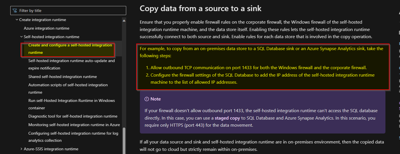

    In case if your sink is Azure SQL then you will have to consider below pre-requisites:
    Ref doc: Copy data from a source to a sink
