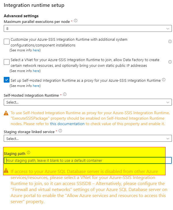

    From the error message, there is some issue with the staging path. Please check if the staging path exists and is set up correctly.
    Also, please remove the staging path and see if it resolves it. If we remove the staging path, the default path is used.
