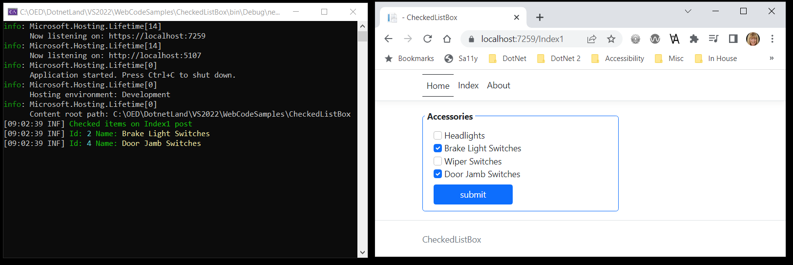

  1. Karen Payne MVP 35,591 Reputation points Volunteer Moderator
    2023-06-08T01:52:25.43+00:00
    The colored console only works for console and ASP.NET Core projects, not Windows Forms.
