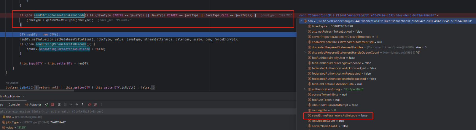

With this in mind I Debug the source code
1686195455387
Through the debug source setObject method, which can be found in fact sendStringParametersAsUnicode properties of false was effective. However, when actually sent to the server, it should still be in Unicode format, so the conversion will be time-consuming, resulting in extremely slow SQL queries.
This problem is more obvious in the larger the data volume of the table
Above is my investigation process, but also hope guys to give some advice
