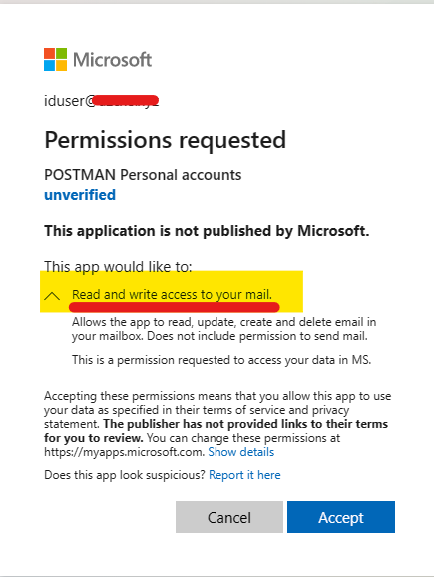

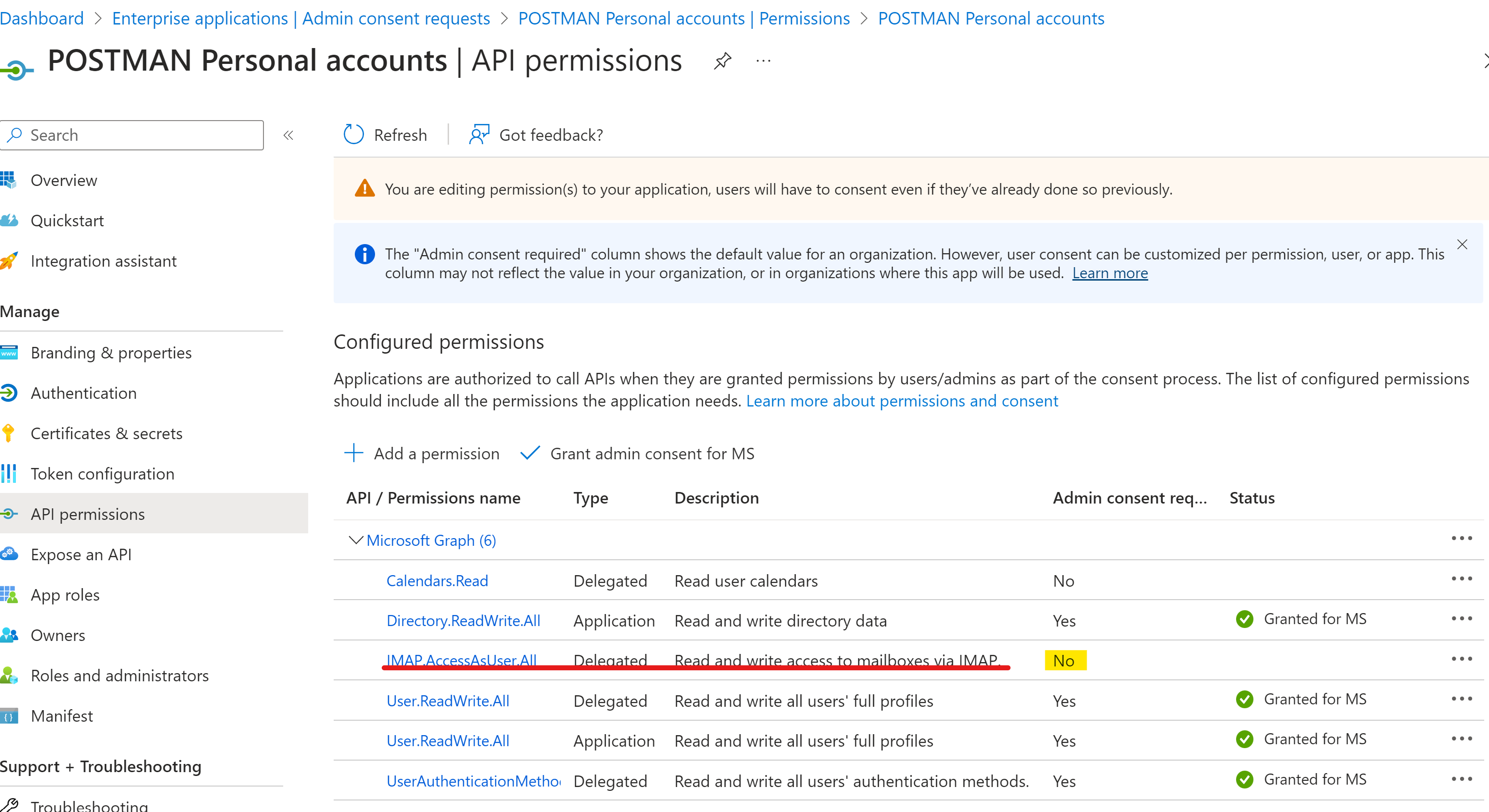

    • The below screenshot shows an application which have IMAP.AccessAsUser.All permission granted but it does not require Admin consent from Global Admin :

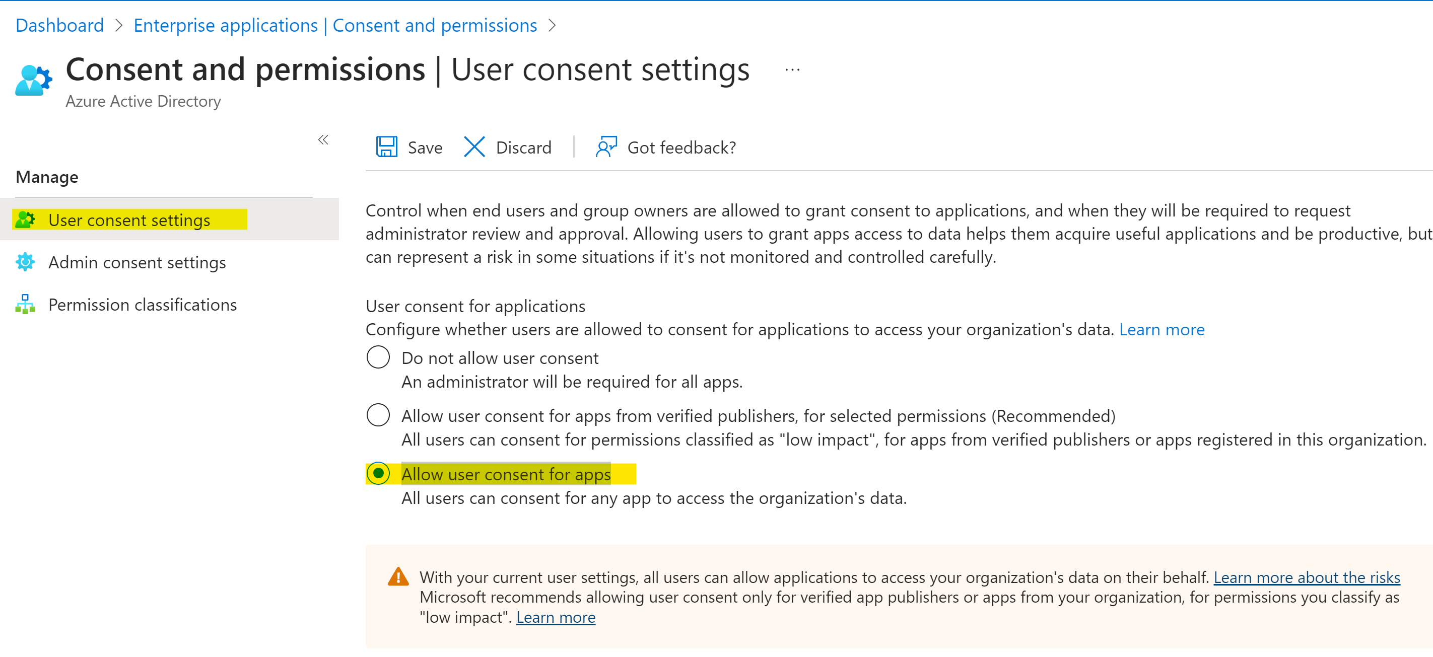

    • And my test tenant User consent settings are set to Allow user consent for apps (All users can consent for any app to access the organization's data.).
    • Such application when accessed by the user requests "User Consent" to access the "mailbox" of the same user.

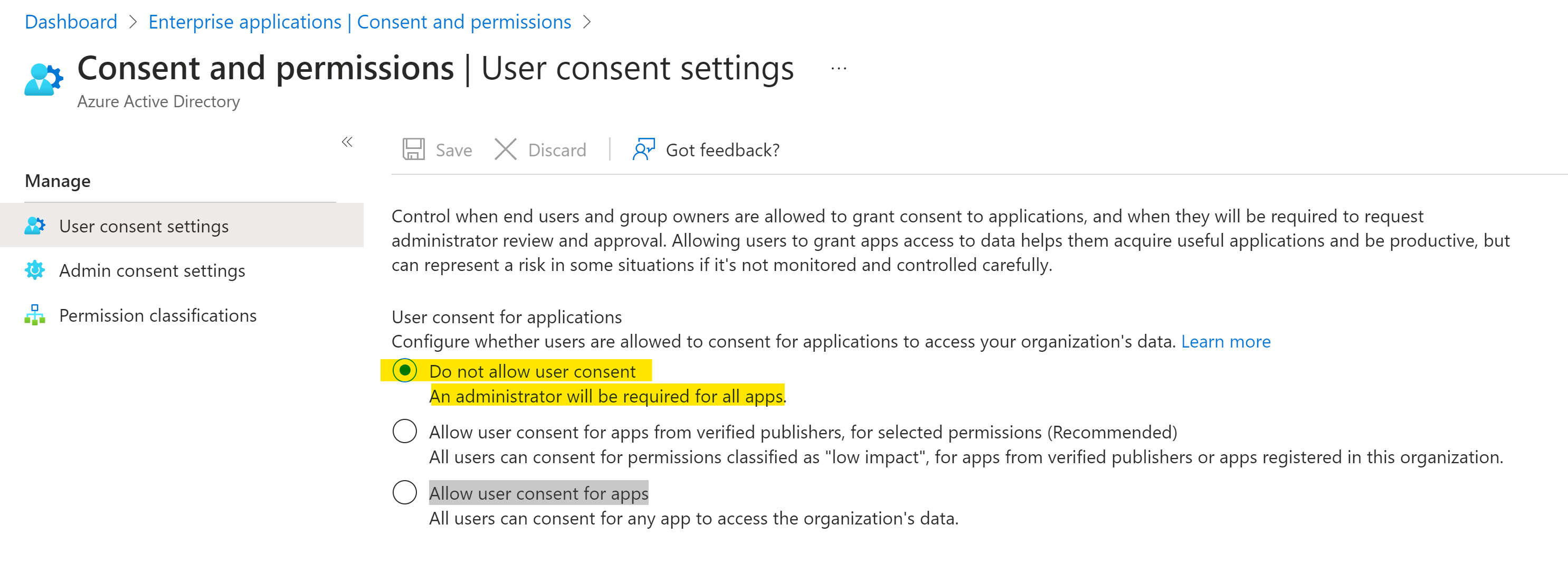

    • However if you don't want this to happen, then we can block it by updating User consent settings to Do Not Allow user consent (An administrator will be required for all apps.).

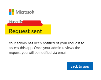

    • This would require the user to send approval request to the admin every time any app requires consent to access organization data on behalf of the user.

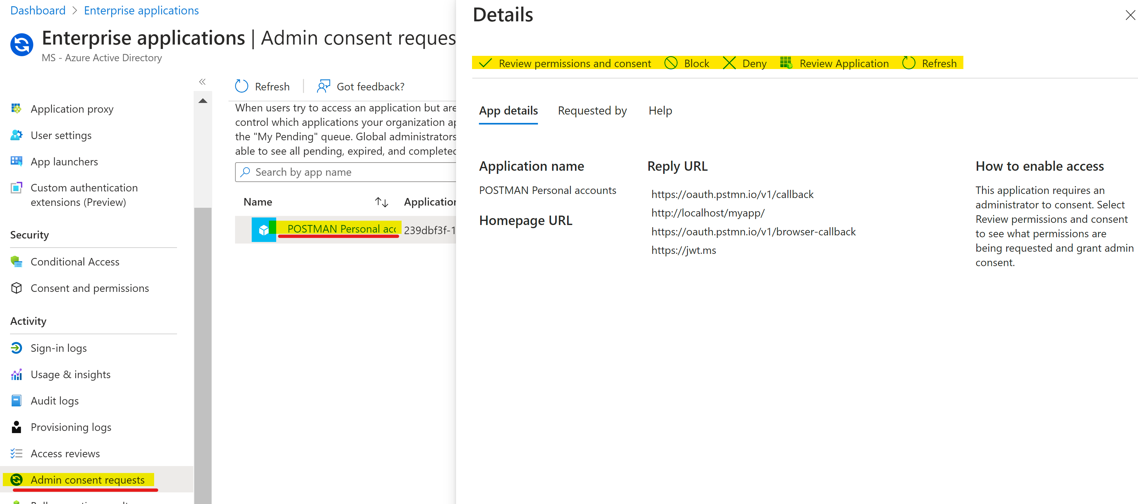

    • Then admin may review and decide if access should be granted or denied for the application.
