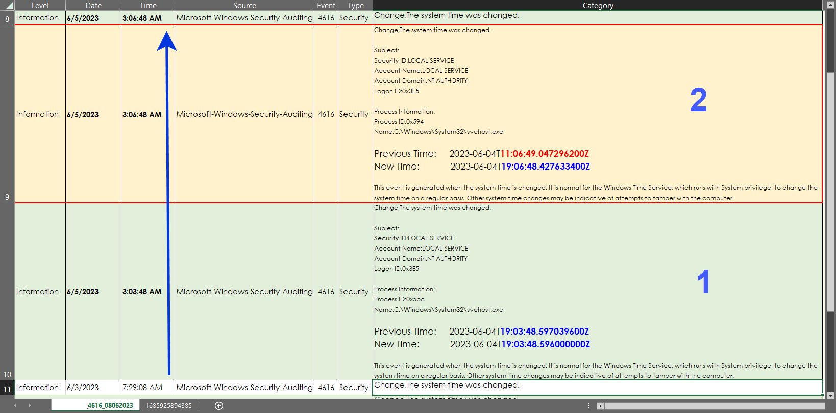

Sometimes we encounter a time change event on our servers (w2k16) that was initiated by Local Service account.
Oftentimes it was just a second or two of adjustment on the system time.
However, there are times it (may) seem to show a big gap in the time difference. Like the example below.
  • Previous Time: 2023‎-‎06‎-‎04T11:06:49.047296200Z
  • New Time: ‎2023‎-‎06‎-‎04T19:06:48.427633400Z
When we check the log, we can't find how the Previous Time (shown above) came to be.
All other log entries shows in the range of 19:06:xx and not 11:06:xx.
We think that the previous time is represented in a different time zone and the new time is our current time zone.
In this case Previous Time is in GMT while New Time is GMT +8.
Is this normal? Any article related to this?

  3. Lance Pogee 20 Reputation points
    2023-06-09T23:32:09.2633333+00:00
    This is what we are trying to check.
    1 - log entry shows the time change of a fraction of a second.
    • Previous Time: ‎ 2023‎-‎06‎-‎04T19:03:48.597039600Z
    • New Time: ‎ 2023‎-‎06‎-‎04T**19:03:48.**596000000Z
    2 - log entry shows the time change made a big jump from 11:06:49 to 19:06:48.
    • New Time: ‎ 2023‎-‎06‎-‎04T**19:06:48.**427633400Z
    No log entry in between showing that the time change back from 19:xx:xx to 11:xx:xx.
  4. Lance Pogee 20 Reputation points
    2023-06-10T13:54:26.26+00:00
    This the System event log entry that coincides with the time change.
    No events on Applications and Services Log\Microsoft\Windows*Time-Service*
