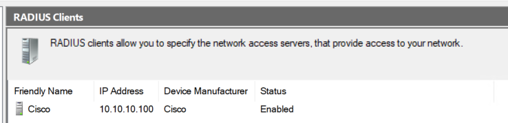

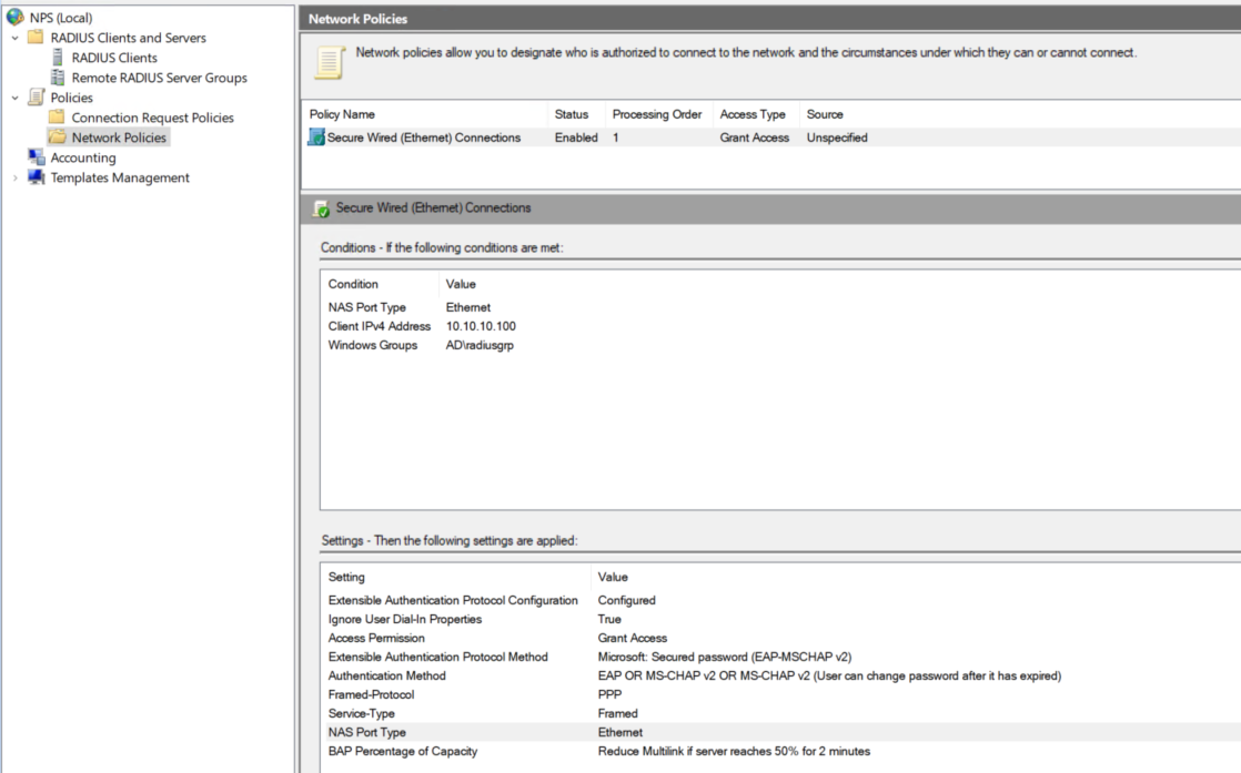

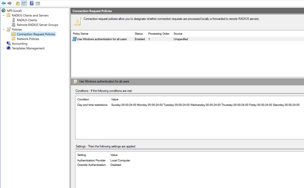

I'm currently in the process of setting up an NPS server and a RADIUS client, which will be my Cisco switch. Once I had configured both the switch and the NPS server, I proceeded to test AAA from the Cisco switch. However, I encountered an NPS error stating, "Authentication failed due to a user credentials mismatch," despite having entered the correct credentials.
This are my NPS Policy & Client configuration:
Screenshot_2

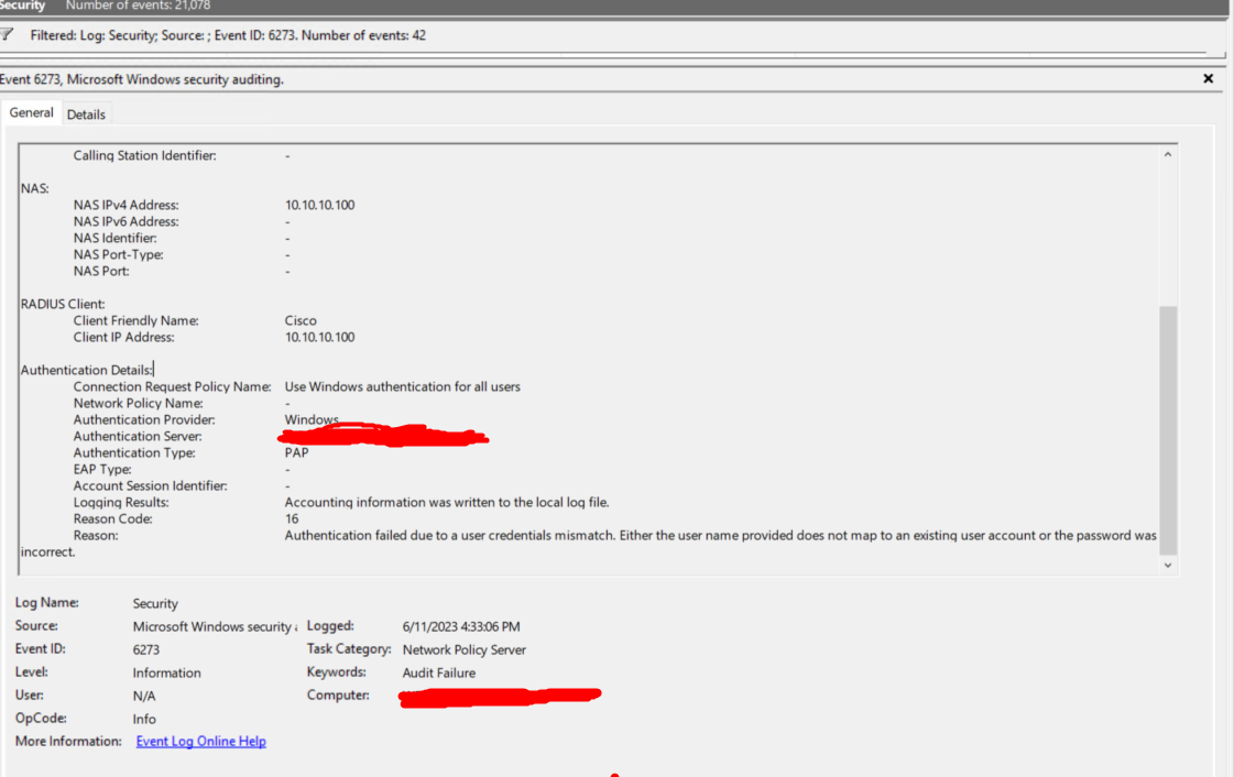

And this is the NPS error log:
Screenshot_1

    Hello Michael,
    The error log mentions "Authentication Type: PAP", but PAP does not seem to be one of the enabled (EAP-MSCHAP-v2, MS-CHAP, MS-CHAP v2) authentication types.
