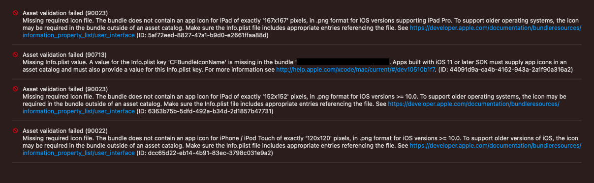

I am trying to upload my Maui app to app store connect. Consistently running into "Asset Validation Failed" for icon sizes 120x120, 167x167, 152x152, 1024x1024.
However, every once in a while it will go through totally fine, I didnt do anything different in those cases.
So far I have ensured the appicon is set to MAUI icon. That it is a multiple of 8. I have tried cleaning and rebuilding, deleting bin and obj folders all in different sequences. I have also tried switching back to the sample .NET maui appicon with no luck.
I can also confirm that the contents.json file is referencing the appicons correctly and all the appicons that are "missing" are present inside the release xcassets folder. I reference this xcassets folder in the info.plist.
I was able to publish the sample maui app with no issues. I have tried cross referencing this sample project with mine (namely the csproj file & info.plist) and I do not really see any difference.
I have opened up the ipa file and "decrypted" the assets.car file. I notice that when my app uploads successfully the appicons are referenced in this file and when it doesnt work they do not. But I do not understand what causes this difference.
Has anyone run into a similar issue. Or has anyone been able to modify an ipa after creation and resign and reseal it and publish to appstore?

    What ended up solving the issue was targeting a physical ipad when archiving instead of the generic device.
