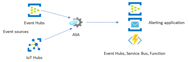

    As far I can tell, Azure Stream Analytics does not have a built-in capability to send email alerts. You can use either Event Hub approach you pointed or use Azure Functions. Please refer the below architecture you may follow to achieve the use case you are looking for.
    I prefer Azure functions approach as it is easier to integrate and come up with a solution. You can refer the QuickStart How to send an email using Azure Communication Service which provides a sample code on how you can send an email alert from Azure Function. Once you have the Azure Function created, you can follow the steps under the section Update the Stream Analytics job with the function as output to bind the stream analytics output to Azure Function.
    Once your stream analytics job is configured to pushes the alert data, you can receive email alerts through your Azure Function.
