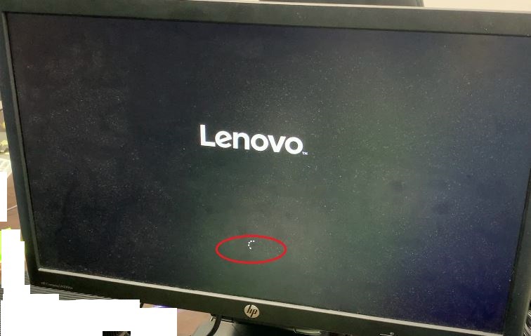

Hello,
Lenovo ThinkCentre M80q Desktop is connected to HP Compaq LA2306 Wide LCD Monitor using Display Port
Installed Operating system is Windows 10 version 22H2.
Lenovo ThinkCentre M80q Desktop is Powered ON. BIOS screen appears.
PowerON
Then Windows Loading
WindowsLogo
Then Black screen appears.
Blackscreen
Monitor need to Turn Off and ON to see the Windows Login screen.
Updated all the device drivers and Windows update. But still the issue exits. Same behaviour happens for arount 100 computers.
Please suggest why this black screen appears and how to solve the issue without Turn OFF and ON the monitor?
