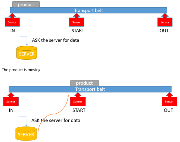

What is better. Maybe async, await is not so complicated.
Can I say it like this?
We do the functions synchronously, who needs it asynchronously must solve this himself.
The used source https://blog.stephencleary.com/2013/11/taskrun-etiquette-examples-dont-use.html
Conclusion: do not use Task.Run in the implementation of the method; instead, use Task.Run to call the method.
The key here is that the solution does not belong in the service. It belongs in the UI layer itself.
Let the UI layer solve its own problems and leave the service out of it.
var result = await Task.Run(() => MyServerData.IsProductResult(77));
return result;
I have a very difficult time with the spelling. How can I still write this? How do I pass parameters? I have seen something like this.
var result = await Task.Run((t1,t2,t3) => XXX t3 is the return value. t1,t2 the passing value?
How do I **cancel **the function, the function when I would click cancel. Is there a pattern way? Here my sample code.
