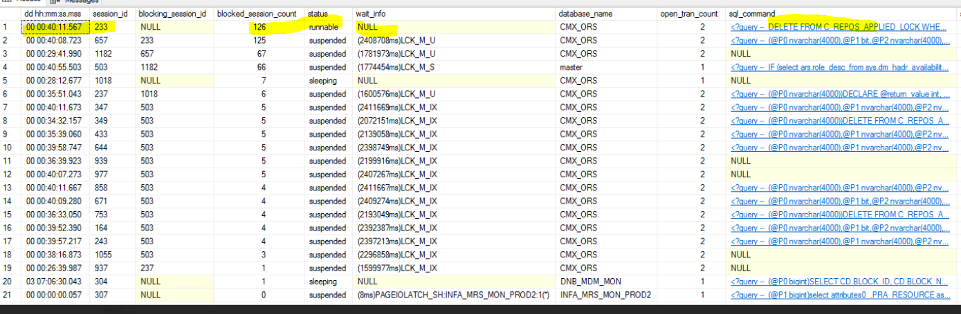

On one of the production environment, a DELETE statement was running over 50 mins and blocked more than 100 sessions.

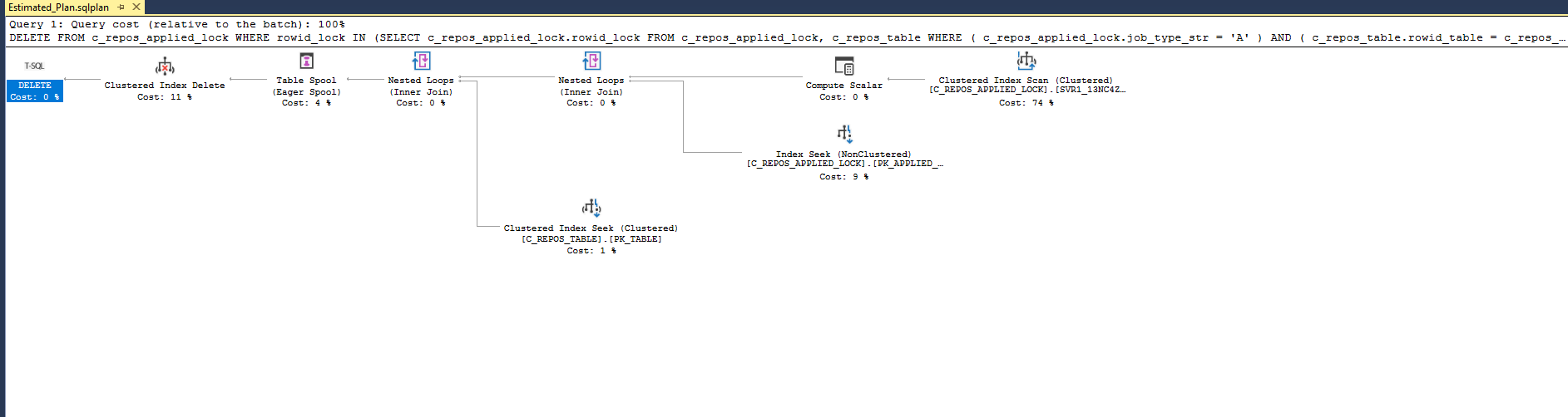

I wasn't able to get the actual plan. However, including estimated plan in the attached zip file.

ran sp_whoisactive during the time of issue and collected some info.
1
spid 233
<--sql text -->
<?query --DELETE FROM C_REPOS_APPLIED_LOCK WHERE ROWID_LOCK IN (SELECT C_REPOS_APPLIED_LOCK.ROWID_LOCK FROM C_REPOS_APPLIED_LOCK, C_REPOS_TABLE WHERE (C_REPOS_APPLIED_LOCK.JOB_TYPE_STR = 'A') AND (C_REPOS_TABLE.ROWID_TABLE = C_REPOS_APPLIED_LOCK.ROWID_TABLE) AND ((DATEDIFF (second, C_REPOS_APPLIED_LOCK.CREATE_DATE, CURRENT_TIMESTAMP )) > (C_REPOS_TABLE.BATCH_LOCK_WAIT_SECONDS * 3)))--?>

  1. Why DELETE is slow? It took more than 50 mins and as per app team confirmation, we had to KILL the spid eventually. was it is reads more data? usually, we don't see more than 10-15 rows in this table at any moment of time. I don't know why I see a lot of reads at that time frame. please refer above screenshot.

blocking-what is the blocking spid doing
blocking screenshot
estimated plan
plan
Estimated plan url :
https://www.brentozar.com/pastetheplan/?id=B1uqt4_P3

    The reason you see U locks, is that SQL Server takes these locks while locating the rows. In this case, it scans c_repos_applied_lock and as it finds rows to delete, it takes a U lock which prevents other processes from changing the rows. Readers are not blocked, though.
    You should rewrite this condition:
     Datediff (second, c_repos_applied_lock.create_date,
                  CURRENT_TIMESTAMP) ) > (
                    c_repos_table.batch_lock_wait_seconds * 3 ) ))
    so that it reads:
    c_repos_applied_lock.create_date < xxx
    Where I leave it to you to figure out the logic for xxx. The key is that when you entangle a column in an expression, SQL Server cannot figure out how to use any index on the column.
    Then again, since there is a column from the other table in the expression I am not sure how much this will help. And there has to be an index on create_date for it to be worth trying.
    Maybe it is better to select the rows to delete into a temp table and then write the DELETE against the temp table. This will reduce the blocking. Although, the rows will be read with shared locks that are released, so other processes could go and do something with the rows. Then again, if they are to be deleted, this may not be an issue.
