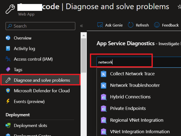

    --You may always leverage App Service diagnostics from Azure Portal> Navigate to your App Service app in the Azure Portal. (screenshot below)
     In the left navigation, click on Diagnose and solve problems - Review and run – Network troubleshooter
