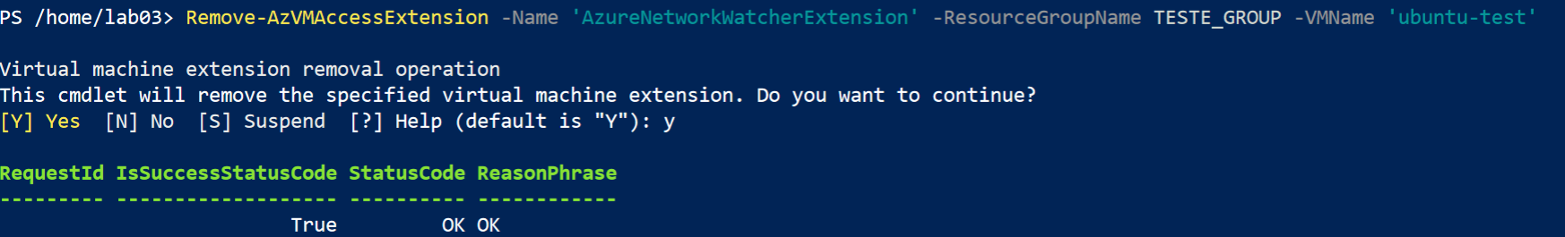

  1. Jackson Martins 10,621 Reputation points MVP Volunteer Moderator
    2023-06-15T13:10:57.2666667+00:00
    Hi @Daniel Sotreanu
    you can use the PowerShell Remove-AzVMExtension cmdlet to forcefully remove the extension. This command would look something like this:
    Remove-AzVMExtension -ResourceGroupName "ResourceGroup11" -VMName "VirtualMachine07" -Name "VMAccessForLinux" -Force
    After running this command, Azure should forcefully remove the extension from your VM. If the operation is successful, it won't return any output. If there's an error, it should return an error message that can help you diagnose the issue.
    Use -Force parameter, This parameter will force the removal of the extension without asking for user confirmation.
    Please replace "ResourceGroup11", "VirtualMachine07", and "VMAccessForLinux" with the actual names of your resource group, virtual machine, and extension, respectively.
    Reference: https://learn.microsoft.com/en-us/powershell/module/az.compute/remove-azvmextension?view=azps-10.0.0#examples
    Get in touch if you need more help with this issue.
