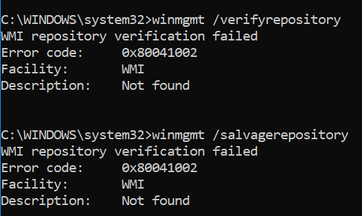

My research have brought me to the conclusion, that since this incident I might have some problem with the WMI repository, since when I run the admin command line and use the below command I receive the below answers:

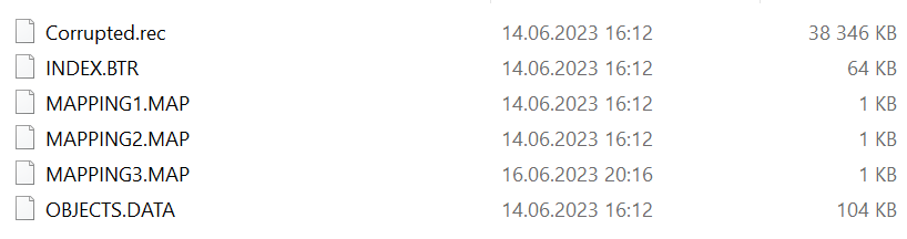

Also I have the following files in the location: C:\Windows\System32\wbem\Repository
But apart from the above (notification about the WSCSVC service being off and no green status on windows defencer) everything works just fine, that is I am able to browser the Internet, listen to the music, browser my files, play games, install windows updates etc exactly the same as before. So my main question is, whether should I even bother with this corruption, since it yields no actual problems with the PC performance? I am literally unable to find any sort of actual problems caused by it. So, is there any reasonable reason to bother with it?

  1. Shujun Chen (Shanghai Wicresoft Co Ltd) 5 Reputation points Microsoft External Staff
    2024-01-08T02:07:03.2733333+00:00
    Hello,
    Thank you for posting in Q&A forum.
    Here are some basic troubleshooting steps we can take:
    1.Open CMD as admin and run
    sfc /scannow
    to repair corrupted system files.
    2.Open CMD as admin and run
    dism /online /cleanup-image /restorehealth
    to fix potential windows corruption errors.
    1. Check WMI Service:
    Run Win + R and "services.msc" and press enter.
    Locate the "Windows Management Instrumentation" service.
    Ensure it is set to "Automatic" startup type and is running.
    Don't forget to restart your windows machine after and check if it works.
    Hope this answer can help you well.
    Best Regards,
    Shujun
