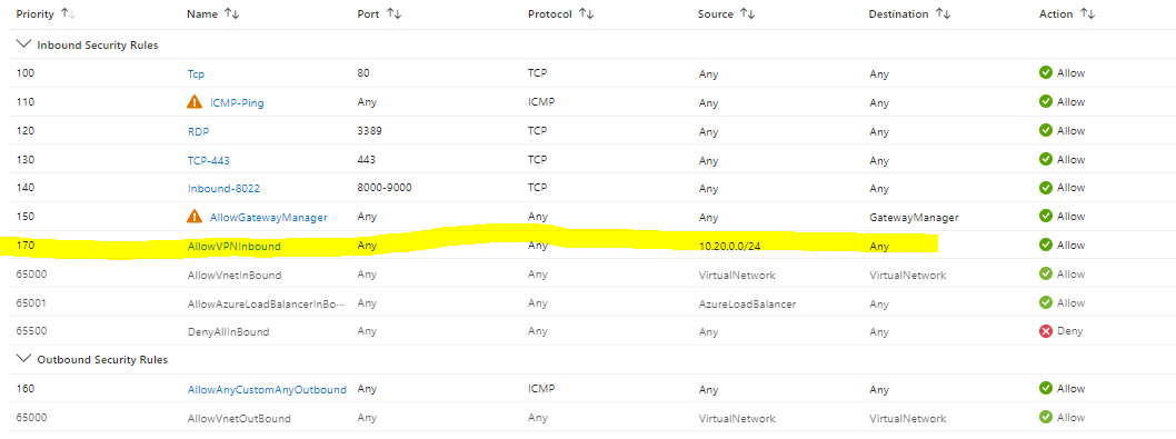

We have a service fabric cluster with single node. We tried to connect the On prem VPN server through S2S connection. Now the connection was succeed and can able to ping the OnPrem network Ip address from the VMSS instance through RDP. But we can not ping the SFC Cluster VMSS instance ip address from the On prem firewall

    Check the network security group (NSG) rules: Make sure that the NSG rules for the SFC VMSS instance allow inbound traffic from the on-premises network. You may need to create a new NSG rule to allow traffic from the on-premises network.
