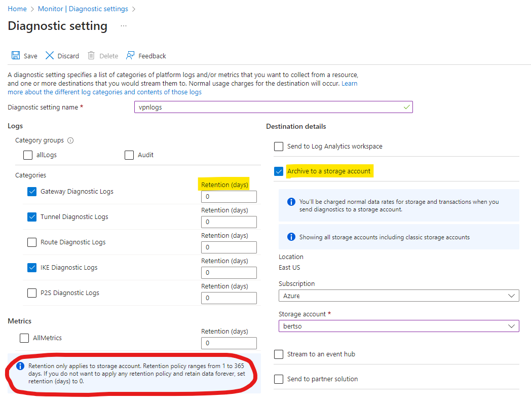

    Retention period settings are configured in Diagnostic settings tab of Azure monitor in case you are sending the logs to a storage account as below:
    If the logs are being sent to log analytics, then the retention period is set/changed at the workspace/table level:
    https://learn.microsoft.com/en-us/azure/azure-monitor/logs/data-retention-archive?tabs=portal-1%2Cportal-2#configure-the-default-workspace-retention-policy

    It actually depends on how you've configured logging in Azure.
    If you check the Diagnostic Settings for the Gateway, you're able to specify which logging categories to capture and where to send the logs. ref: https://learn.microsoft.com/en-us/azure/vpn-gateway/troubleshoot-vpn-with-azure-diagnostics
    Even after configuring logging you also might find that the retention period on your logs has lapsed and they have been deleted. Again, this is user configurable - so you'll need to inspect the logging solution that was configured.
