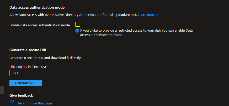

My user has the Owner, Contributor, and Data Operator for Managed Disks roles assigned at the Subscription level (shown below), and I have enabled data access authentication mode via the documentation here: https://learn.microsoft.com/en-us/azure/virtual-machines/windows/download-vhd?tabs=azure-portal#enable-data-access-authentication-mode

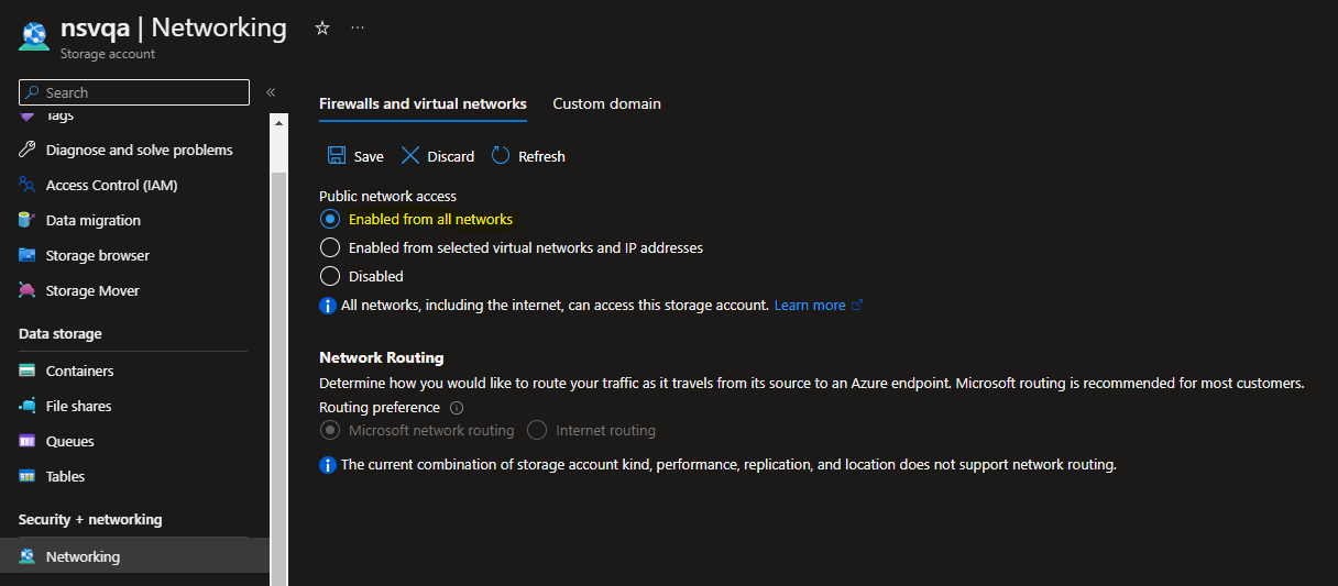

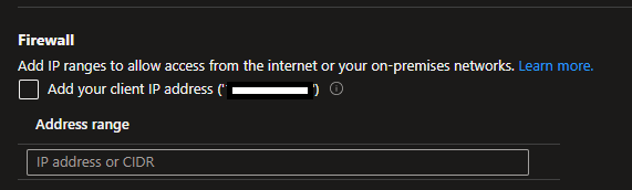

    Try to check the firewall on Storage Account:
    If you enable the option "Enabled from selected virtual network and IP address" means the firewall is enabled:

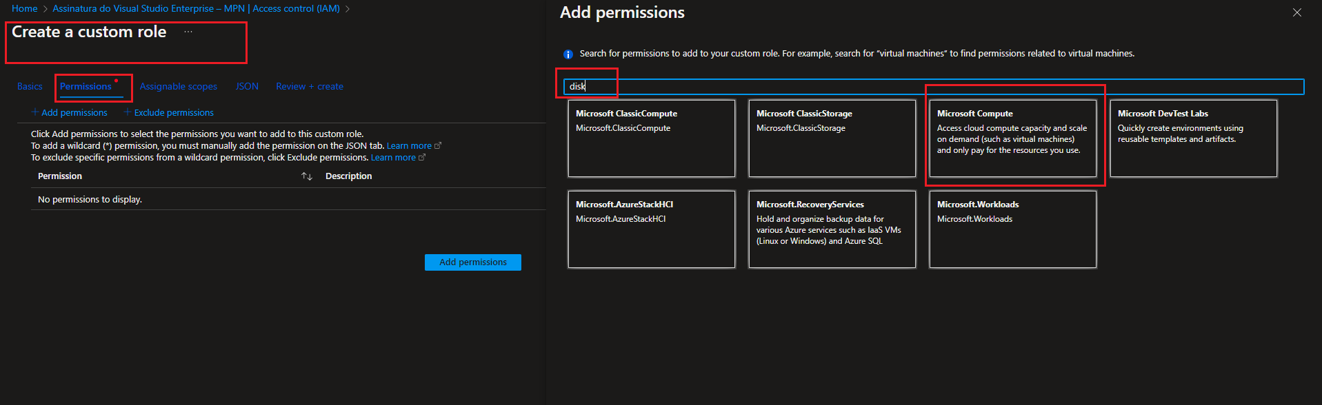

    You also can create a custom role and give the necessary permission to download the vhd:
    Go to Subscription -> IAM -> Add -> Add Custom role:
    custom role

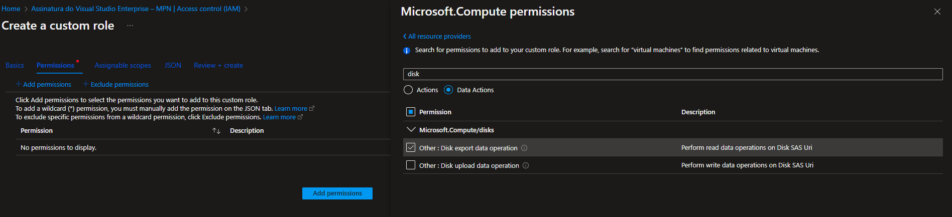

    Select Microsoft.Compute/disks/Action:
    custom role2
    You can also remove the authentication mode by unchecking the option when creating the URL:
