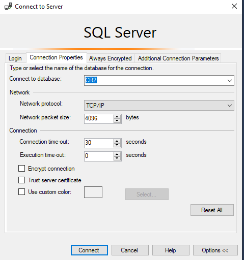

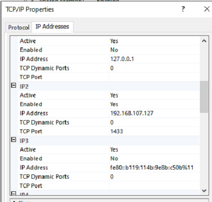

I installed the SQL server on Windows Pro 10. I can access the app from my pc but get the 'can't find the SQL server' error when trying to access from another PC. Not firewall, or SQL database config. It is set to allow remote connections. I can connect with my app using SQL authentication or Windows authentication from my PC but no others. Why can the app not find the SQL server but i can connect using PowerShell, etc ? What is am I missing, will this only work if I move the SQL server over to a server and not run it on a Windows Pro 10 PC? Even though Microsoft says it should work on a Windows 10 computer.
