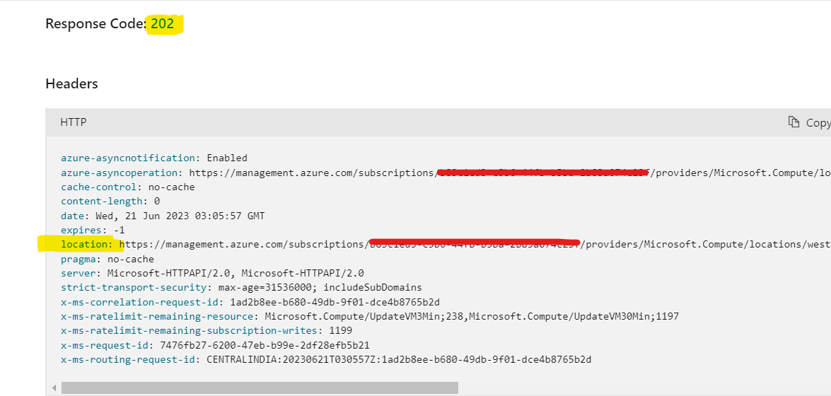

    Please note that the output response for the above REST API would look like below:
    Note that the status code is 202, which means Accepted. This being an ASYNC operation it will send a Location response header. This Location header url needs to be invoked again in subsequent request inorder to get the desired output. And this is by-design.
    So to simplify this process, the easiest way is to run the Invoke-AzVMRunCommand PowerShell cmdlet, this makes the same above REST API call underneath. Also this will query the Location header in subsequent request the background and will eventually display the desired output. See the below sample script and its corresponding output:
