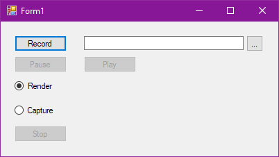

  2. Duarte Vinagre 60 Reputation points
    2023-06-22T09:25:03.8633333+00:00
    There is a lot of code in the link i probably do not need and also do not understand..could you simplify?..all i wanna do is record mic and line in
