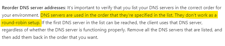

    By default, DNS servers are used in the order that they're specified in the list. They don't work as a round-robin setup. If the first DNS server in the list can be reached, the client uses that DNS server, regardless of whether the DNS server is functioning properly.
    enter image description here
    So, you should add the DNS server addresses in the correct order for your environment. If they are not in the correct order, you should remove all the DNS servers that are listed, and then add them back in the order that you want.
    Refer: https://learn.microsoft.com/en-us/azure/virtual-network/manage-virtual-network#change-dns-servers-of-a-virtual-network-using-the-azure-portal
