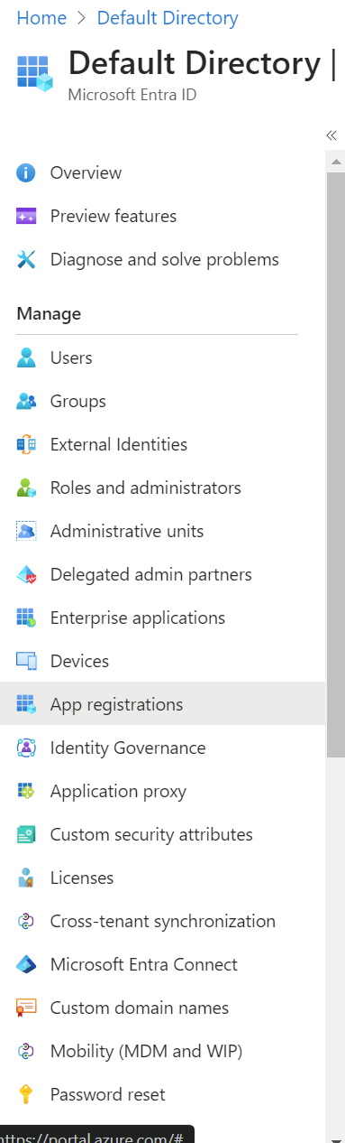

    Thank you for you answer! I cannot find my client ID. The only thing I find is a
    "tenant ID" in the folder Tenant details in Azure Active Directory. Is this the desired ID?
    Thanks
