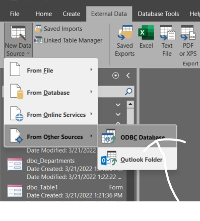

    So, now, we choose external data, odbc.
