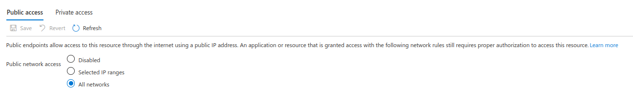

According to the portal, the IoT Hub is reachable from all networks

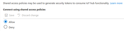

and connecting via shared access policies is also permitted. We are using the same iothubowner connection string to manipulate device twins from different locations inside and outside the Azure network.

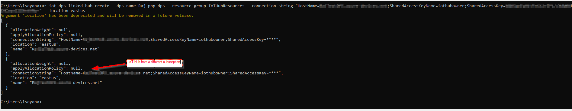

    I have tested the same command to establish a connection to IoT Hub on a different subscription. I have got the similar output from the command execution as you pointed. Please find the below image for reference.

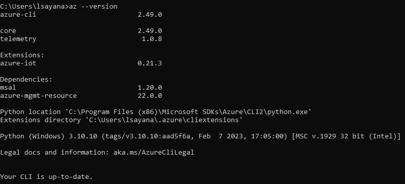

    I have made sure that the Azure CLI, core and extensions are on latest versions by verifying az --version command. Here are the details on the command.
    If you notice your CLI is not up to date, you can execute the az upgrade command to upgrade any dependencies.
