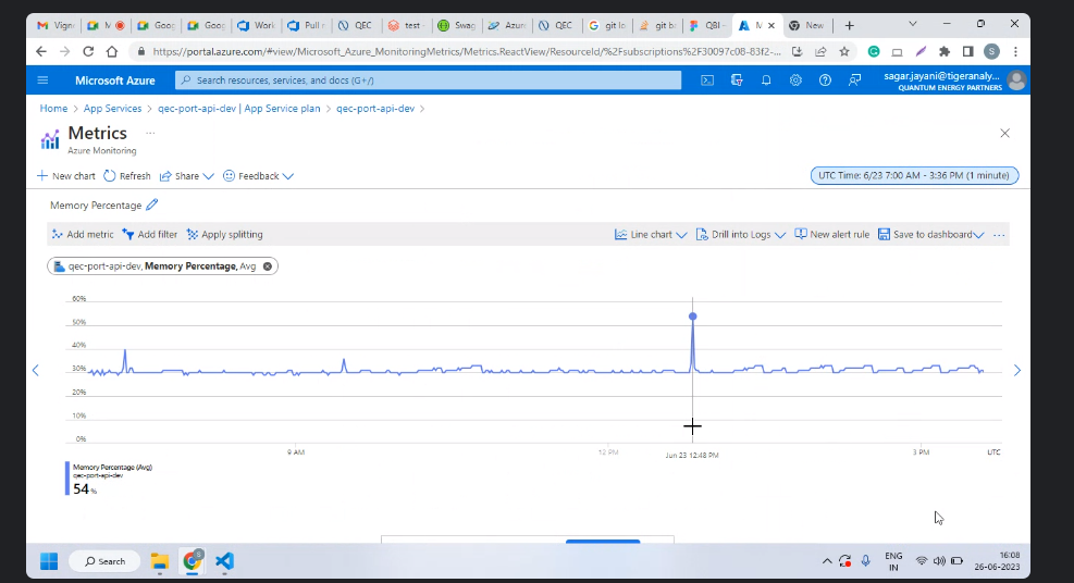

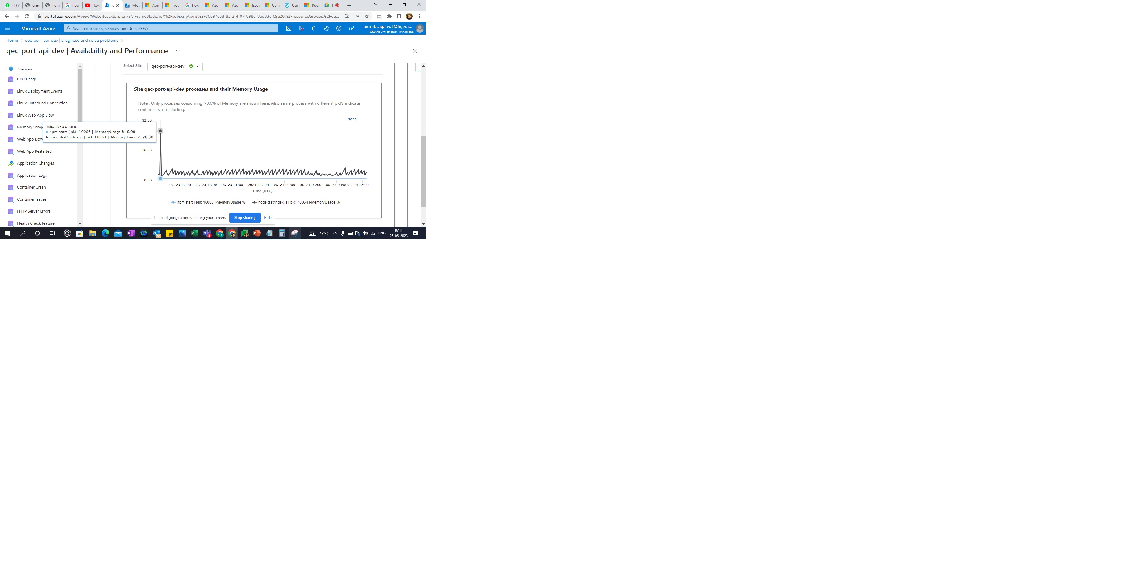

I have a basic B3 instance on an APp Service Plan and only have one app running on the plan. The memory of the application is 7.5gb and the application generally runs at ~30% memory consumption. When I read a particular dataset from Databricks that is a mere 30mb dataset, the memory shoots up to 60% (please see image attached). I tried to drill down to process level memory consumption and there's only one process that is taking up 24% memory when I run that query. This is not adding up to 60% memory utilisation that I see on the main page. Also want to understand why 30mb data is causing the memory utilisation to 60%?

    It's possible that you may have a memory leak or the memory usage you are seeing is due to memory fragmentation. Memory fragmentation occurs when the memory used by an application becomes fragmented over time, making it difficult for the application to allocate contiguous blocks of memory. This can cause the application to use more memory than necessary, even for small datasets.
    In your case, it's possible that the 30MB dataset is causing memory fragmentation, which is causing the memory usage to increase. This could be due to the way that the dataset is being loaded into memory or the way that the application is allocating memory.

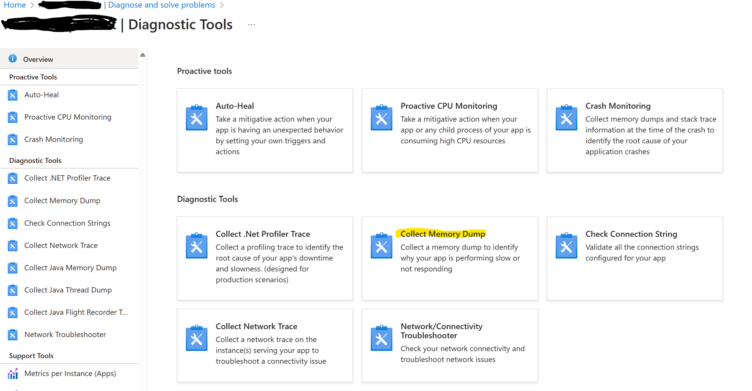

    To diagnose the issue, do a memory leak analysis by going to your App Service in Azure portal > Select the Diagnose and Solve problems blade > Click the Diagnostic Tools tile. Select the Collect Memory Dump tile where you can create your memory dump by configuring a blob storage to save it to.
