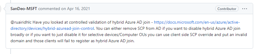

    Well, I'm sure you have seen this:
    https://albandrodsmemory.wordpress.com/2021/04/15/how-to-disable-hybrid-azure-ad-join/
    But I cant vouch for it or if its supported
