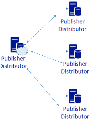

We have serval servers; one is the azure VM, Others are the local servers.

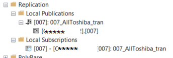

We deployed the SQl server in the azure VM as the data central server. Please refer to the following picture.
We use the transaction synchronization function of the SQL server. When we deploy data synchronization between multiple points, the data in the database will roll back.
When we deploy data synchronization between azure server and one local server, the data in the database will work normally.
My question is :Does azure SQL server in the VM support transactions are synchronized at various sites? Or it is the limitation?
