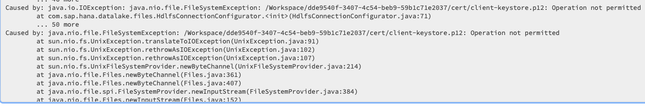

What is the valid path for the files under workspace? I tried using the below path, where I have given the read access to all the users.
/Workspace/dde9540f/cert/client-keystore.p12
But ended with the error shown below
Caused by: java.io.IOException: java.nio.file.FileSystemException: /Workspace/dde9540f/cert/client-keystore.p12: Operation not permitted
