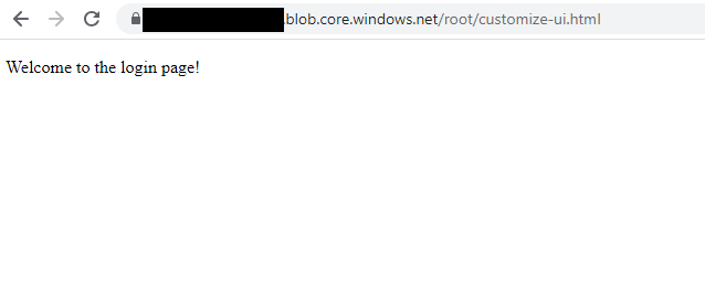

When I open the page from blob storage it works as expected:CwY4I

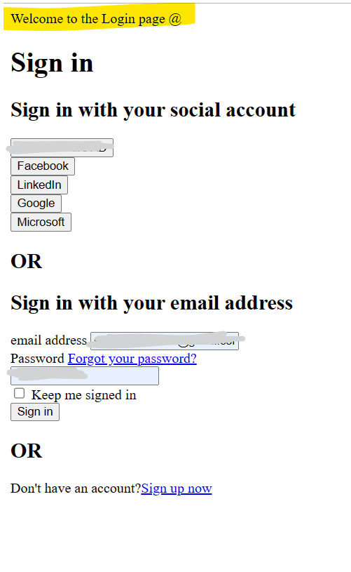

However when loading the sign in page the welcome text is missing:B2CPage

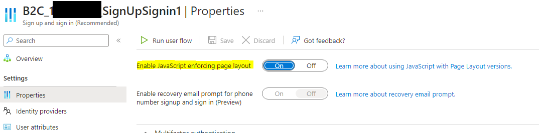

  3. Javascript is enabled:
JSEnabled

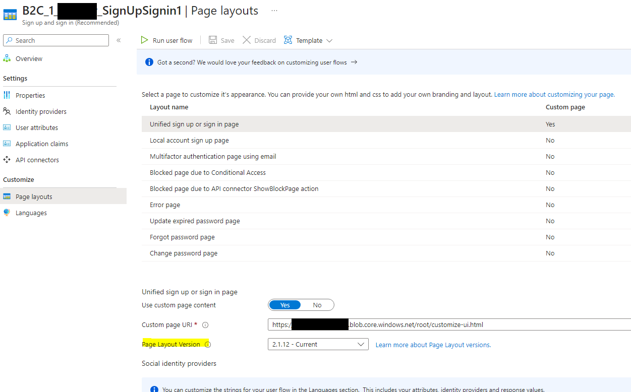

  1. I'm using version 2.1.12 of page layout (and have tried other versions with no luck):
PageLayout

  1. Shweta Mathur 30,431 Reputation points Microsoft Employee Moderator
    2023-07-05T13:33:34.0066667+00:00
    Hi @Sean Jolly ,
    Thanks for reaching out.
    I tried to addAs a workaround, you can create a label and add Text to it.
    <!DOCTYPE html>
    <html>
    <head>
        <title>Login</title>
       <script>
    		var label = document.createElement('label');
             label.appendChild(document.createTextNode('Welcome to the Login page @'));
             document.body.appendChild(label);
    	</script>
    </head>
    <body>
    <div id="api"></div>
    </body>
    </html>
    which shows javacSript label on your customized page.
    Hope this will help.
