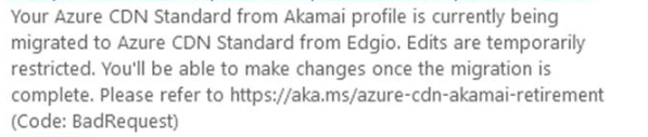

    2. If you are using CDN endpoints such as xyz.azureedge.net without a custom domain, then manually migrating the CDN endpoint without downtime is not possible because you won't be able to create multiple Azure CDN profiles with the same endpoint name.
    3. The only way to manually migrate your CDN endpoint will be to delete the old CDN endpoint and reuse it in another CDN provider. The endpoint should be available to re-use within 5 to 10 minutes of its deletion, but you should consider some downtime which is needed for the creation of a new endpoint and updating DNS records. NOTE: It is not possible to rename a CDN endpoint. So you need to create a fresh endpoint with the required endpoint name as soon as it is deleted from your Akamai CDN profile.
    4. You can wait until we auto migrate, and that migration is expected to be graceful. With the Nov 1 auto migrate: the profiles and endpoints will remain consistent; the downstream provider will be changed behind the scenes from Akamai to Azure CDN Standard from Verizon
