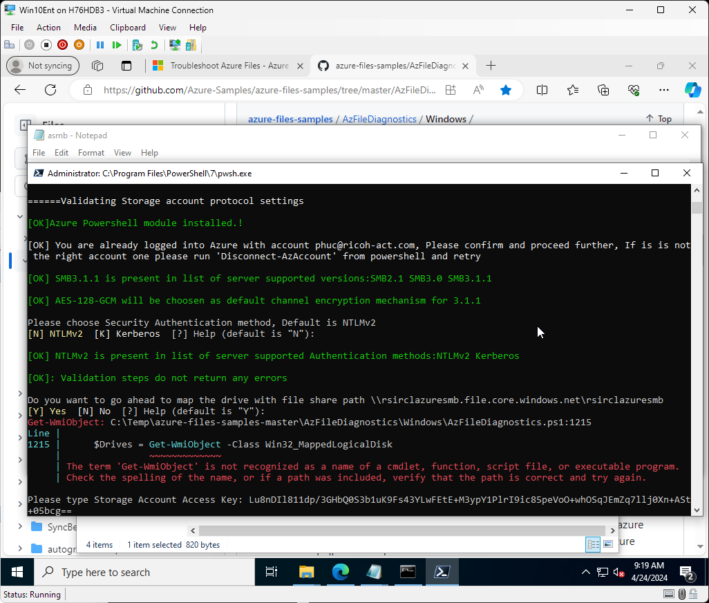

    When running AzFileDiagnostics at the part where it attempt to map the drive using the Azure logged on account, there is Get-WmiObject error at line 1215, @Sumarigo-MSFT any ideas why is it failing here?vmconnect_zc6CCS4Ljd.png

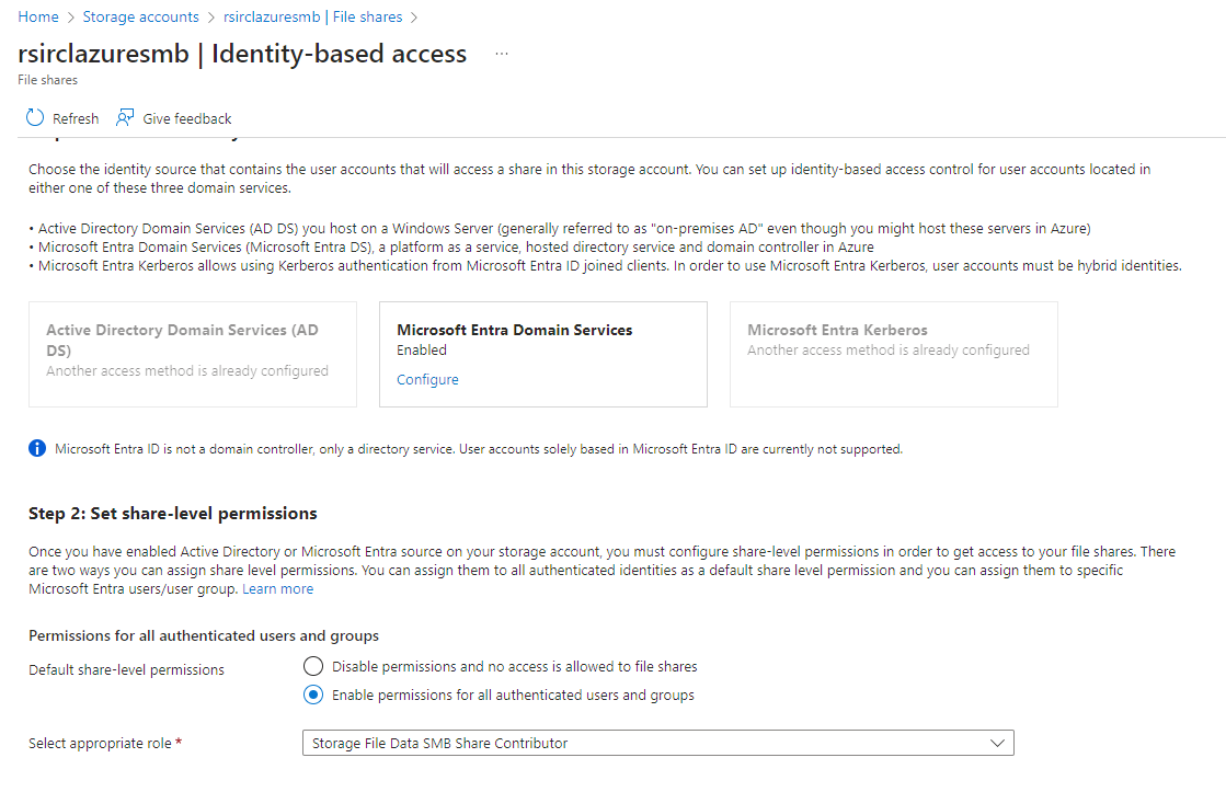

    This is a Azure AD (Entra ID) only setup and the Azure File Share identity source is configured to use Microsoft Entra Domain Services, share-level permission is all users and groups are Storage File Data SMB Share Contributor. share-level-permissions.png

    2024-04-24T18:34:22.4533333+00:00
    Revisiting this issue again in 2024. Last year worked with MS for several weeks but no resolution. Now when running AzFileDiagnostics getting error like https://github.com/Azure-Samples/azure-files-samples/issues/179
