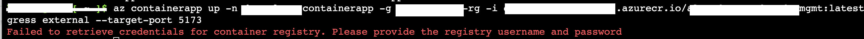

I have an nodejs application image stored in a private ACR with admin credentials disabled. I have created a containerApp with system assigned managed identity which has the azrPull role on the private ACR.
The containerApp has been created with a public image.
I try to update the containerApp with the following task in devops
steps:
    - task: AzureContainerApps@1
      inputs:
        azureSubscription: $(armServiceConnection)
        acrName: $(acrContainerRegistry)
        containerAppName: $(CONTAINER_APP_NAME)
        resourceGroup: $(RG_NAME)
        imageToDeploy: $(acrContainerRegistry).azurecr.io/$(acrImageRepository)-$(Build.SourceBranchName):latest
        containerAppEnvironment: $(CONTAINER_APP_ENV_NAME)
        location: $(CONTAINER_APP_ENV_LOCATION_NAME)
        ingress: "external"
        targetPort: 80
before this task the
- task: Docker@2
successfully builds the application image and stores it in acr. When this task is run i check the logs:
/usr/bin/bash -c CA_ADO_TASK_ACR_ACCESS_TOKEN=$(az acr login --name myregistry --output json --expose-token --only-show-errors | jq -r '.accessToken');
docker login myregistry.azurecr.io -u 00000000-0000-0000-0000-000000000000 -p $CA_ADO_TASK_ACR_ACCESS_TOKEN > /dev/null 2>&1
/usr/bin/az containerapp up -n mycontainerapp -g myrg -i myregistry.azurecr.io/mybranch-dev:latest --ingress external --target-port 80
ERROR: Failed to retrieve credentials for container registry. Please provide the registry username and password
if i execute the same commands from my local system the below command
gives the same error:
role_assgined_azrpull
image_pull
same error in pipeline as well as local system. Can anyone help?Thanks
