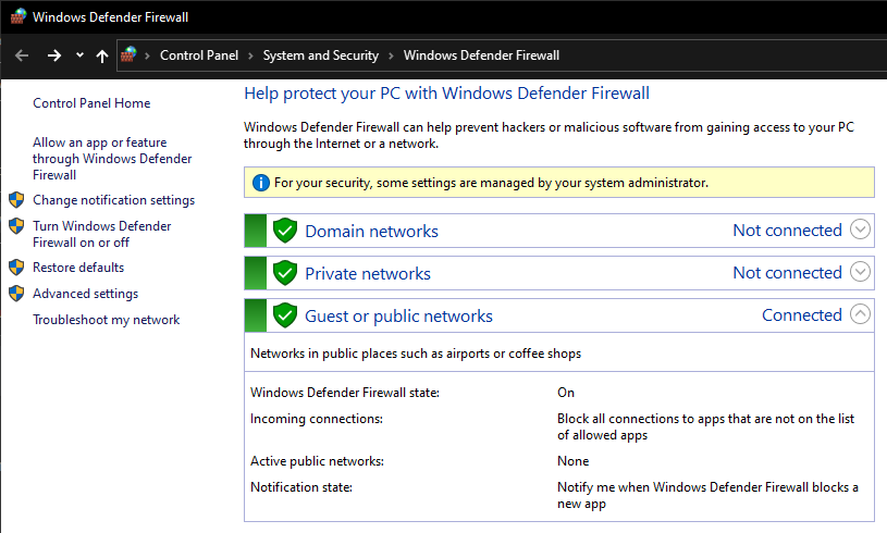

Suddenly our PC that Joined to a Domain has Incorrect Network Profile on Windows Defender Firewall:

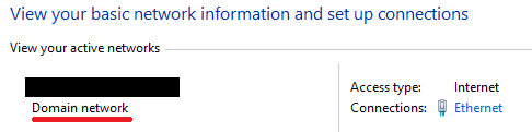

But Connection Profile in Network Settings is Correct:

This is happening Randomly and usually fixed when PC Rebooted after Issue happening.
Please be kindly advise, Thanks in advance.
