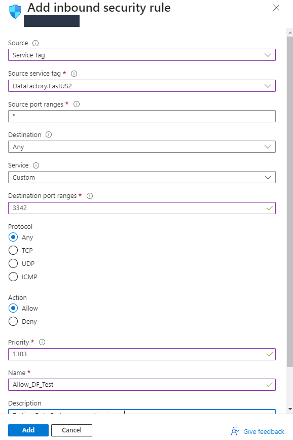

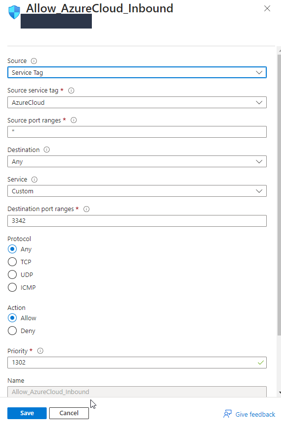

    Or you can also automate that by creating a Managed Instance and Data Factory/Synapse
    You can use the below query in the Script activity of the Data factory
    RESTORE DATABASE [dbname] FROM URL = N'https://abcxxxxx.blob.core.windows.net/<>/dbname.bak'
    Please find the below screenshot (similar one), select Script Activity and use the linked service for the Managed Instance and place the .bak files in the Storage account and use that path in the query.
    The .bak will be restored once the script activity is executed and that's how you can automate that process using Data Factory.
