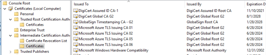

    When installing the certificate on the Gateway Server from the link as shared (Azure Certificate Authority details), ensure that you are using the Store location as "Local Machine" as shown below:
    Hope this helps.
