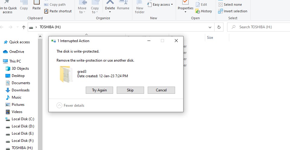

Hello,
I have a usb I wanted to store some files in it it gives me This disk is write-protected it won't store files nor formatting I tried the solutions that mentioned on the internet I tried the registry file solution it didn't work then I tried cmd disk clear readonly it didn't work either I tried softwares like easeus to disable the protection it didn't work too and there is no bitlocker on it and no physical switch what is the problem and how to solve it I can do nothing with it except copy files from it and paste them elsewhere nothing else what is the solution.12

  1. Docs 15,761 Reputation points
    2023-07-13T06:56:16.5066667+00:00
    The unexpected disk is write protected is unfortunately often a failure message.
    The flash drive can be tested for confirmation.
    https://www.tenforums.com/tutorials/3548-enable-disable-disk-write-protection-windows.html
    Sometimes when a SD card or USB flash drive gives a This drive is write protected error, the device may have failed. The write protected error is an attempt to protect from data loss, so you can copy the contents from the device to another storage location. In this situation, nothing can be done for the device. It's dead.
3 additional answers
  1. S.Sengupta 24,476 Reputation points MVP
    2023-07-12T01:04:00.31+00:00
    If you have tried all the possible fixes but failed to get it corrected, then it is likely your removable disk is broken or gets bad sector.
    2023-07-12T07:54:55.71+00:00
    Have you attempted to connect this USB drive on a different operating system or another computer?
    How about using CMD format X: to format this disk?
  3. Kapil Arya 8,451 Reputation points MVP Volunteer Moderator
    2023-07-12T16:42:45.3266667+00:00
    As you tried all possible options and nothing worked, the USB drive may be malfunctioned.
    If you had important data on this USB, you might need to take help of data recovery professional/service to recover the data.
