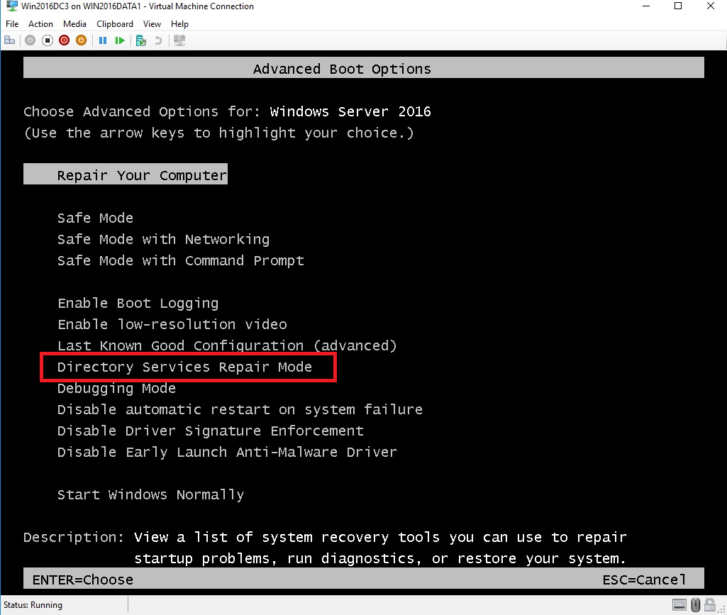

    tried logging into the local administrator account
    There are no local accounts on a domain controller. Might try F8 at startup and choose DSRM mode to see what might have happened.
    enter image description here
