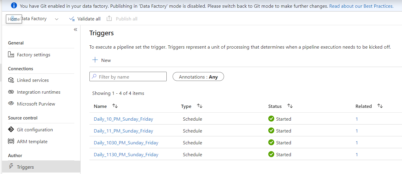

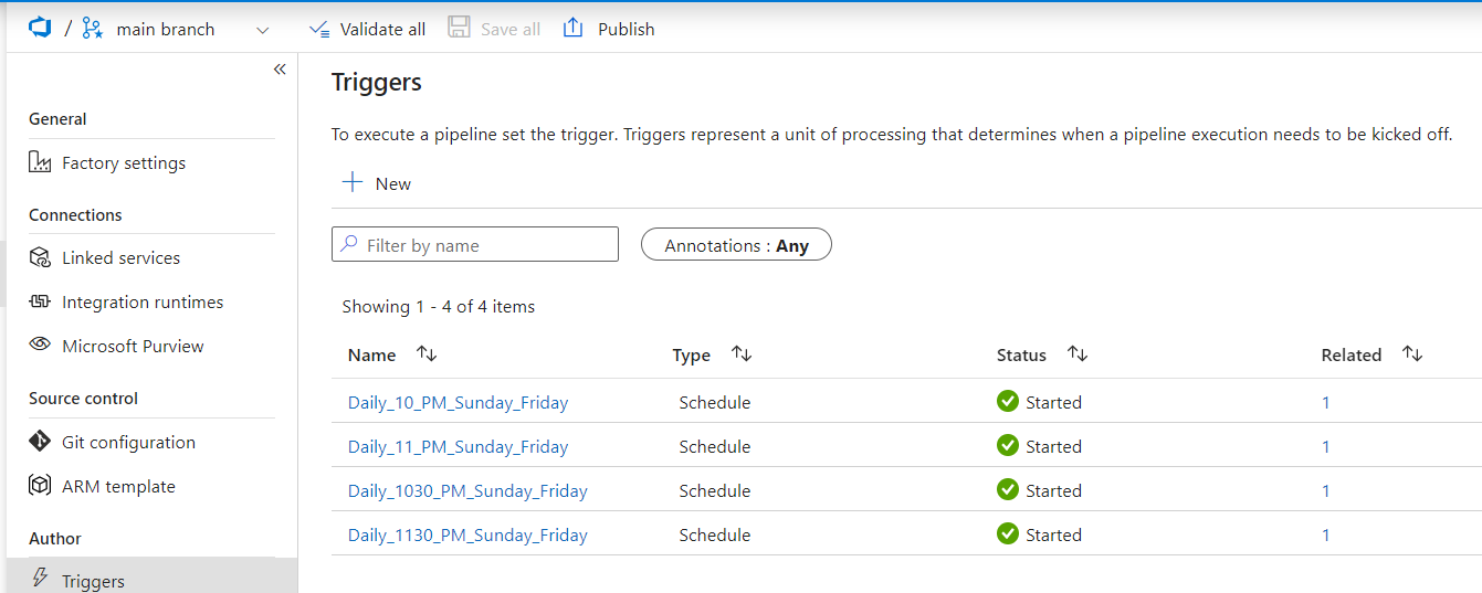

I created the triggers and published from the "main" branch.
I switched to the live mode and verified that triggers are in "started" status.

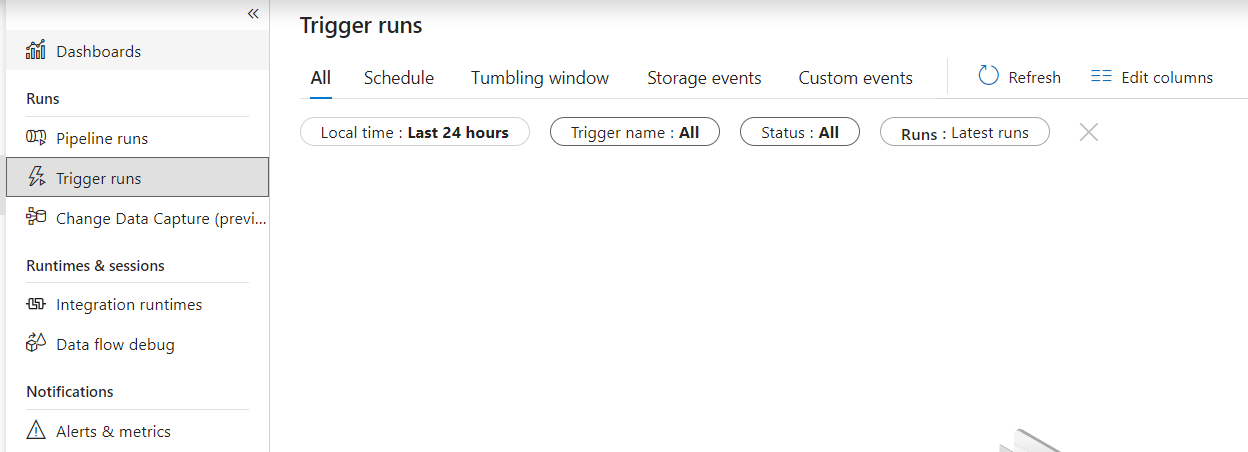

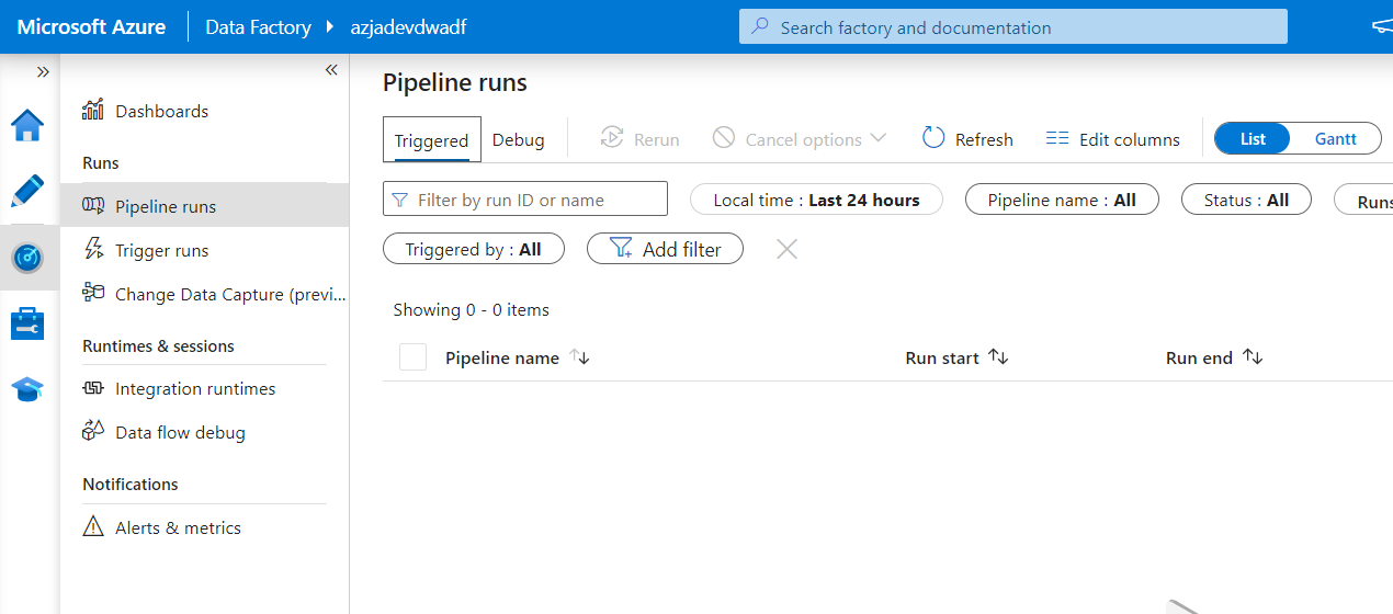

The trigger status is started but they did not run.

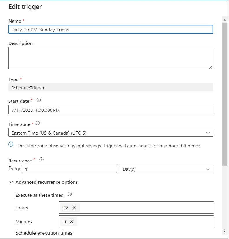

I made these triggers well ahead of time. I made them on 07/10/2023 and scheduled to run on 07/11/2023 starting at 10:00 PM to 11:30 PM
Please see the configuration -

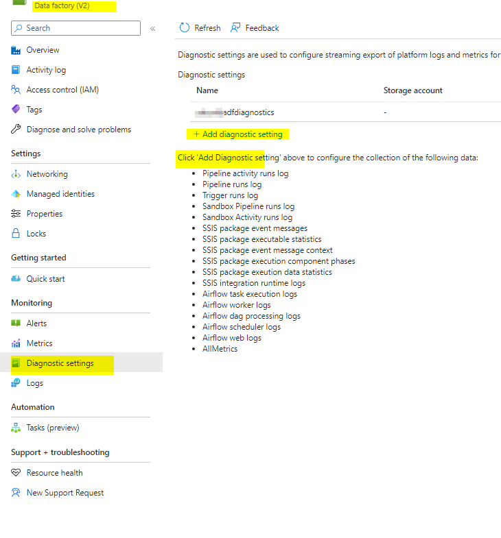

    2. Setup Diagnostic
    suggested to enable the Diagnostic to be able to monitor future occurrences because Diagnostics records who did the change by the user AAD Object ID.

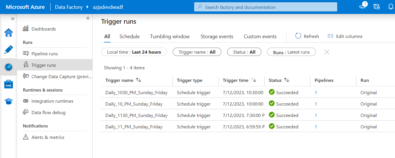

    Updated: 07/13
     Glad to see the Triggers are running successfully, I would recommend to monitor them for the next run window?
    They were supposed to run on 07/11/2023, but they ran on 07/12/2023.
    Might be the window time is effective from the moment we update the trigger, please monitor for further!
    I also noticed the timings for the two, which differed from the Eastern Time Zone, and I changed it to EST today morning.
    It should not be different from what is set during creation of the Trigger, something might have changed in between. We can better monitor the trigger for further updates and we will for sure here to help if something is not right!
