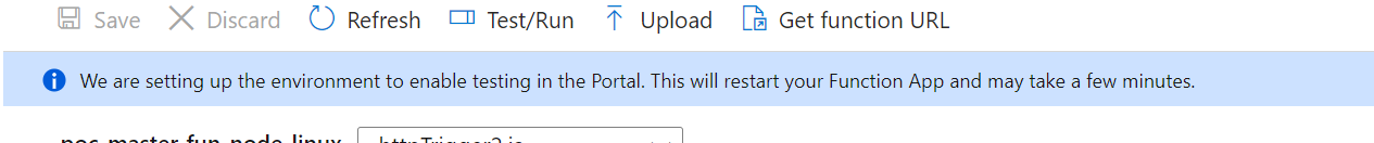

I have created a Function App using VS Code extension(Azure Functions). when I deployed the function and tried to run on portal, I get "We are setting up the environment to enable testing in the Portal. This will restart your Function App and may take a few minutes." notification above code pane as given in belo image; however this notification never goes away and I am unable to run the function on portal.

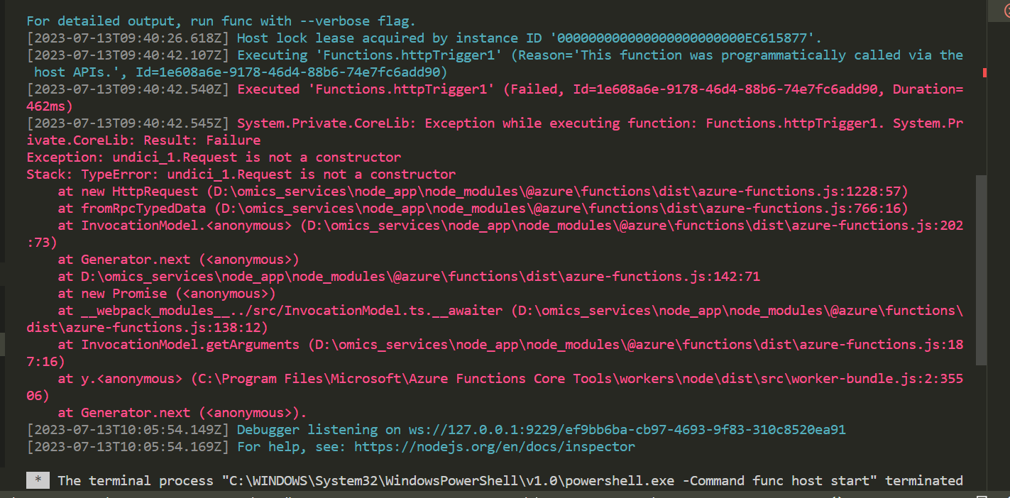

I am also trying to run function locally but unable see list of created function as below:
When I Click on "Start debugging to update this list..." and go to the link provided(http://localhost:7071/api/httpTrigger1), It gives me below error:
Please help me to resolve the issue. Thanks in advance!

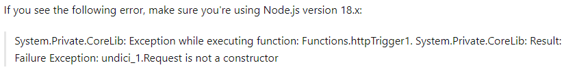

    Anuj Pachawadkar Thanks for posting your question in Microsoft Q&A. This appears to be an issue described here and make sure you are using Node.js version 18.x.
    If it doesn't resolve, share the code snippet, functions runtime version/node.js version, configuration etc.? That will help us understand the issue better. Or you can also file the issue in GitHub repo azure-functions-nodejs-library.
