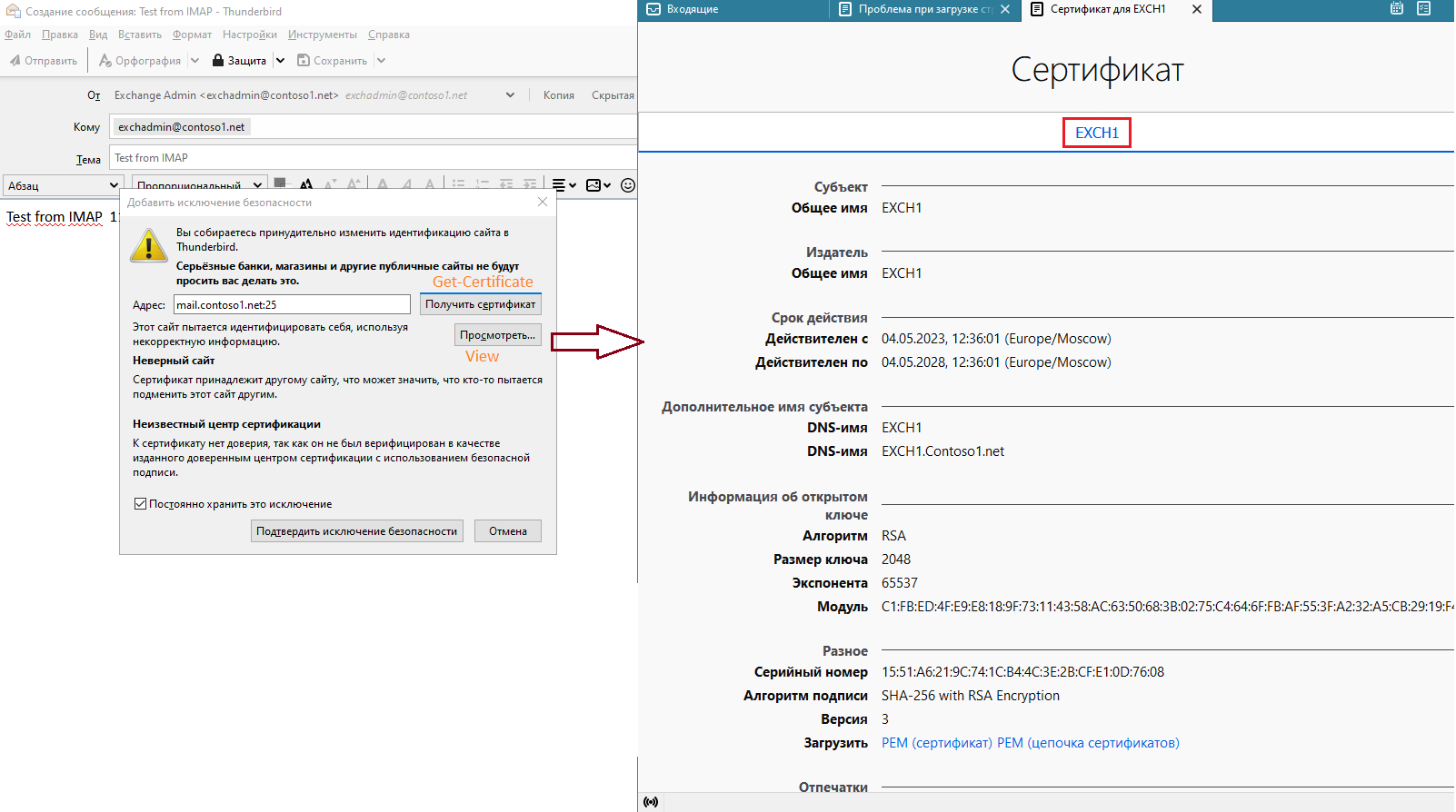

...for testing purposes needed to enable IMAP/SMTP for internal client and was puzzled by the following: as I didn't want to use TLS I had configured the imap-client (Thunderbird) to use ports 143 and 25, nevertheless I saq this this error:
01
Thunderbird was complaining that the certificated presented by mail server was not trusted - this was the Exchange Server's "auto-generated" certificate so the two question arise:

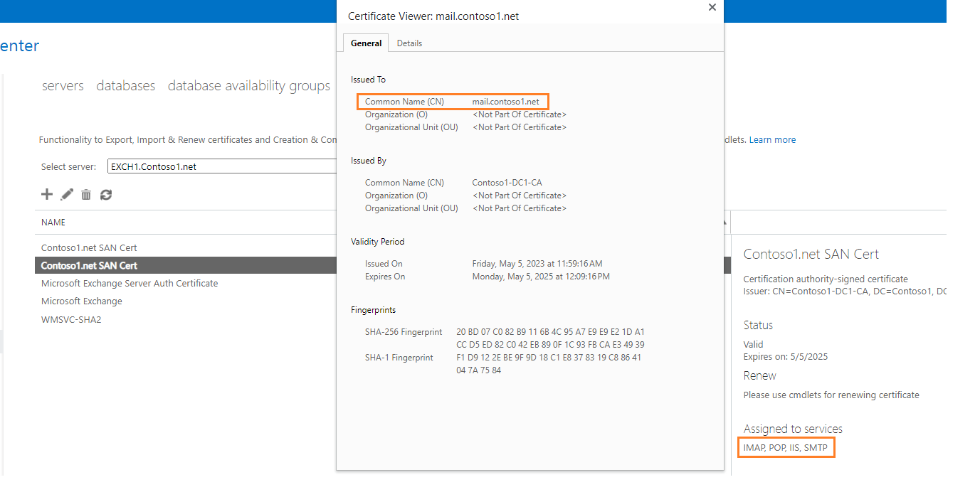

Q1: Why does the sending to port 25 - not secured by SSL/TLS! - lead to Exchange sending its internal certificate to the client?
Q2: If the server does really need to use its certificate even for unecrypted connections on port 25 why didn't it use its "real" configured certificate from my local CA?
    By default Exchange uses Opportunistic TLS:
    Exchange would always first try to establish TLS connection with the client.
    If the connection fails, Exchange would fall back to not using TLS.
    Since TLS connection needs a certificate and the Exchange self-signed certificate was not trusted by the client, it caused the TLS connection to fail, thus the connection did not use TLS.

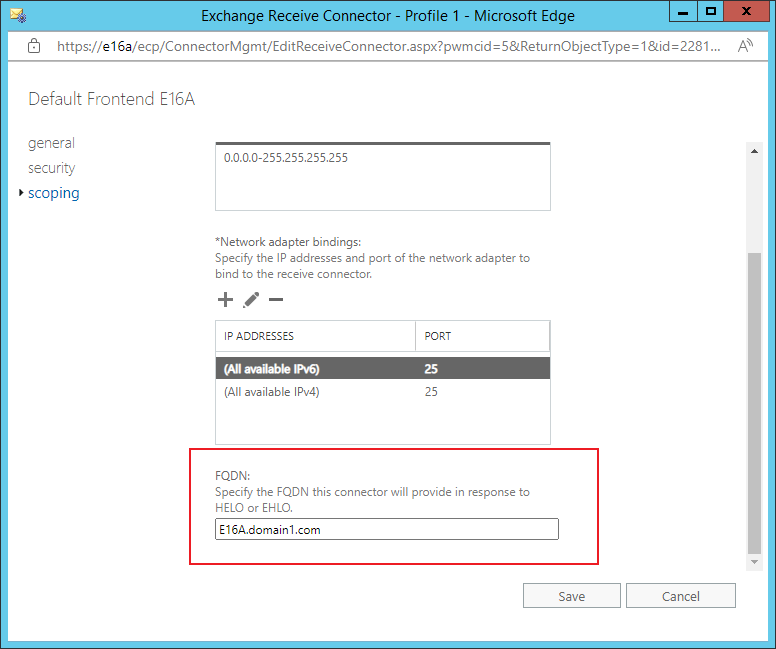

    Have you configured the server FQDN (mail.contoso1.net) on the receive connector (Default Frontend EXCH1)?

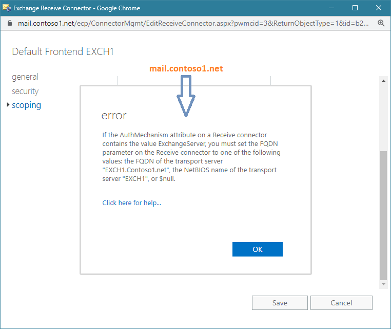

    I tried to change exch1.contoso1.net to mail.contoso1.net and got this:
    03-1
    04

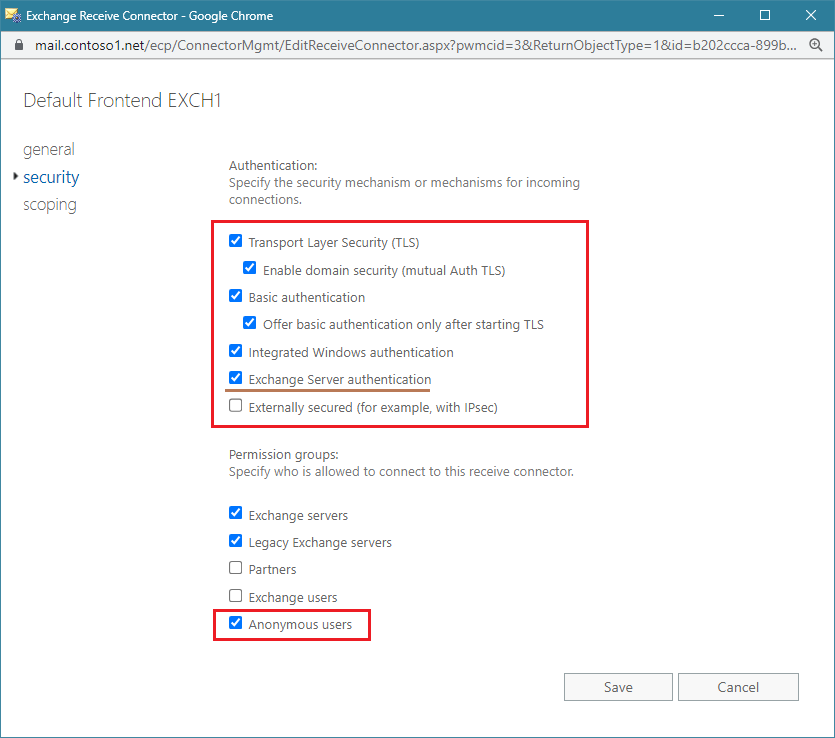

    Removing Exchange servers from the Authentication section does solve the problem but this window - Security tab for Default FrontEnd connector - was always starnge to me: this connector is primarily used for receiving anonymous email from internet servers - what's the purpose of having so many different authentication mechanisms for anonymous email?

    "These authentication (except TLS) are not used by anonymous senders as by default Exchange would accept emails from anonymous senders on port 25, which doesn't require the senders to be authenticated." - this is exactly what I can't understand: if they are not needed why are they there?
    Thank you for your help once again!
