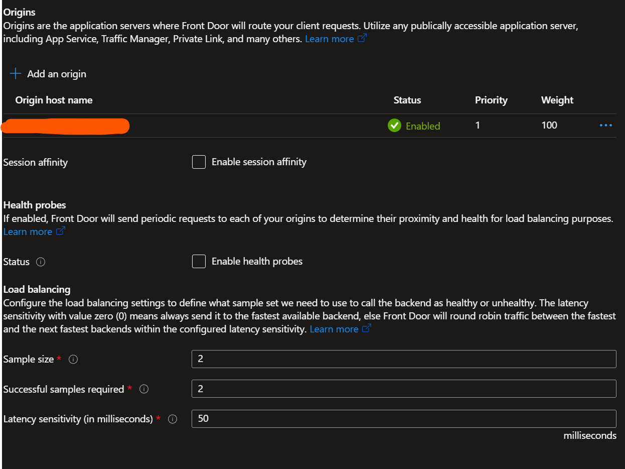

We do not have health probes enabled on origins. Example configuration for an origin:
This issue is occurring for multiple origins, examples:
- Apache on Azure VMSS (Linux)
- Varnish container on Azure Kubernetes Service
- IIS on Azure VMSS (Windows)
This issue is occurring across multiple POPs, example of the 4 second timeout requests logged in the past 3 hours:
Top 10 Values Count % DFW 4 18.182% AKL 3 13.636% YVR 3 13.636% AM 2 9.091% FRA 2 9.091% SIN 2 9.091% ATL 1 4.545% BN 1 4.545% CH 1 4.545% DM 1 4.545%

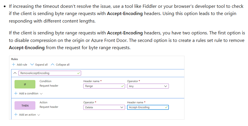

Meanwhile, could you please check the KeepAliveTimeout configuration in your origins and Origin response timeout configuration in your Azure Front Door (The ability to configure Origin response timeout is only available in Azure Front Door Standard/Premium).
Also, check if the client is sending byte range requests with Accept-Encoding headers.
