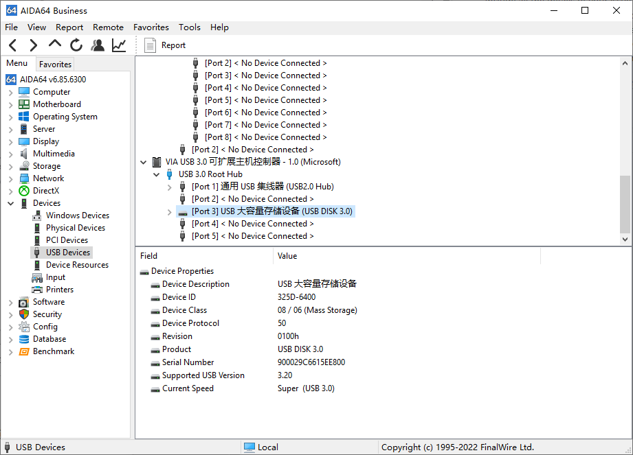

But a few weeks later, when I wanted to backup some files, I found that my SSD enclosure only works in USB 2.0 mode, and the speed is very slow. I tried different USB 3.0 ports, however, the result is the same.User's image
My SSD enclosure is connected to the generic USB hub(通用USB集线器), instead of the USB 3.0 Root Hub just like my Udisk that works normally on USB3.0 :User's image

    Just now, the SSD enclosure could operate in USB 3.0 mode again, and I noticed that it depended on how the enclosure was detected. If it was a "USB attached SCSI mass storage device", then it could function in USB 3.0 mode. If it was a "USB mass storage device", it was restricted to USB 2.0 mode. Do you have any clue about this?
