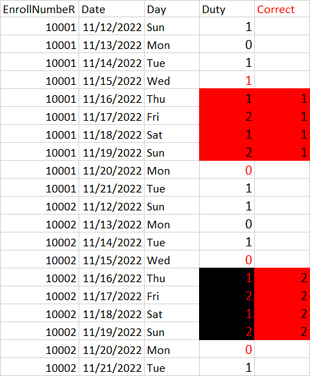

I have already asked this question, but i changes in my table of #MonthDate,please go through
I want ,when day(15-06-2022) before From_Date, Duty is zero and after day(20-06-2022) from To_Date Duty is Zero ,then From_Date and To_Date ,Duty Column will be marked with 2 else if 15-06-2022 or 20-06-2022 is marked with 1 then From_Date and To_Date ,Duty Column will be marked with 1.
below is data

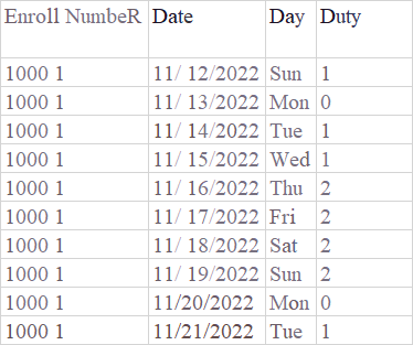

    Hi @Analyst_SQL
    The desired output you provided and your description seem to conflict.
    In the original table, 2022-11-15 is marked as 1, so From_Date and To_Date ,Duty Column will be marked with 1.
    If what you need is the desired output you show, you can try this.
    ;with T1 as(
      select From_Date,To_Date from #MonthDate where Holiday = 'H' group by From_Date,To_Date
    ),T2 as(
      select *,case when A.Date between B.From_Date and B.To_Date then 2 else A.Duty end as D
      from #tbl_Emp_Register as A cross join T1 as B)
    update T2 set Duty = D;
    select * from #tbl_Emp_Register;
    Output:
