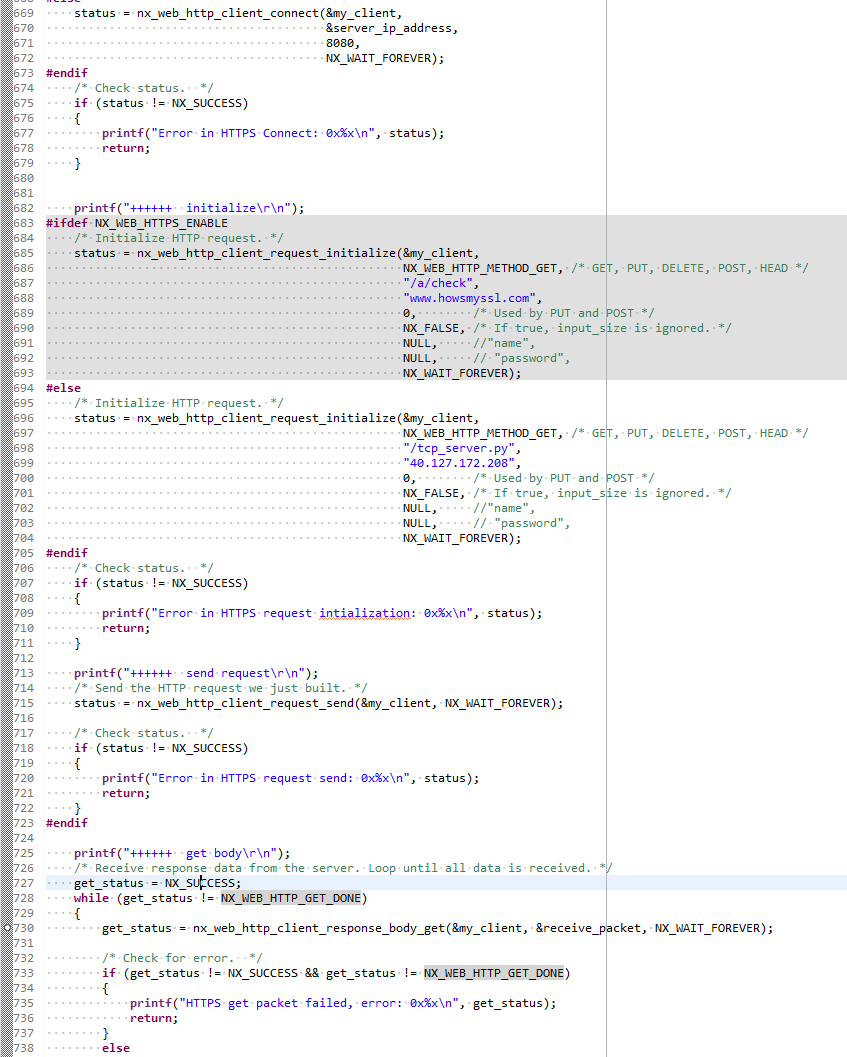

Dear AzureRTOS Technical Support Team,
I am using Netx Duo run on STM32 connect to Cellular Quectel EC21
My code is based on the example demo_netxduo_https.c

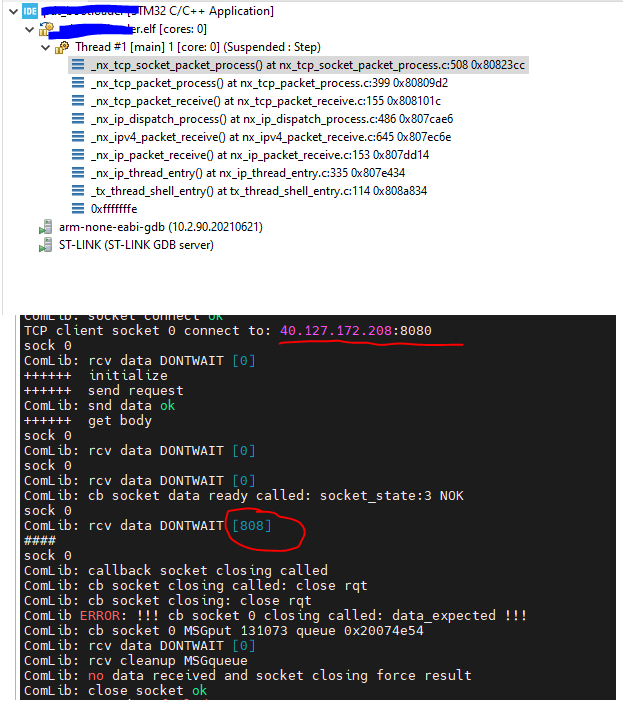

When the device sends HTTP GET to the web server, I see the Netx driver received a packet 808 bytes but didn't see it forwarded to the application layer. After that, the web server closes the connection and i get error code 0x38 (NX_NOT_CONNECTED)
I'm not sure if there's a configuration flag missing
For example, when I used LWIP, I can enable debug log to see the packet flow but I don't know on NetX
I have still been stuck on this issue for one month and don't have any idea to continue to debug
Hope AzureRTOS Support Team gives me an idea to debug it.
