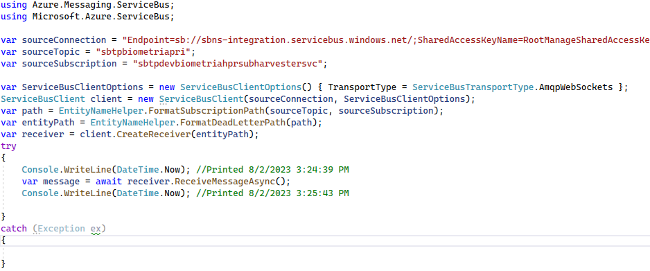

Few days back we added azure function to read messages from DLQ of Topic/Subscription and after processing few messages it started giving null as a value of message even messages are available in DLQ. Due to this it got stuck in DLQ and we are not able to process messages from DLQ.

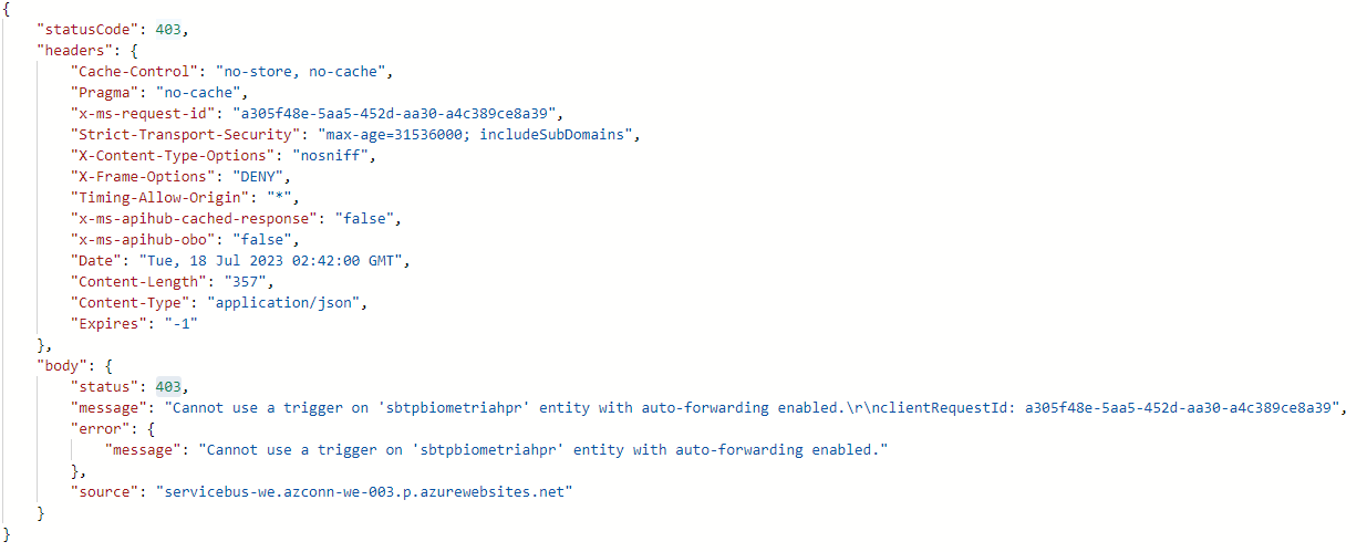

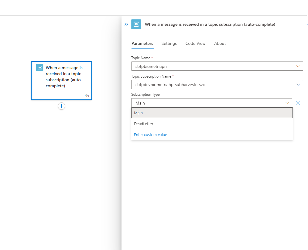

To investigate it further we added the logic app workflow as well to process messages from DLQ and we are getting below error
Error message clearly says that, when auto forwarding is enabled then we can't read messages from topic.

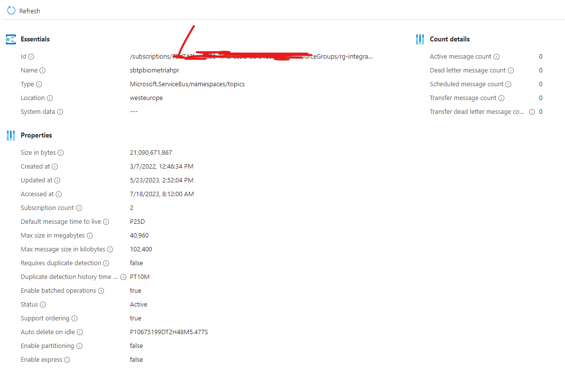

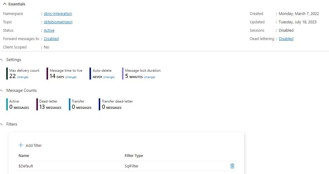

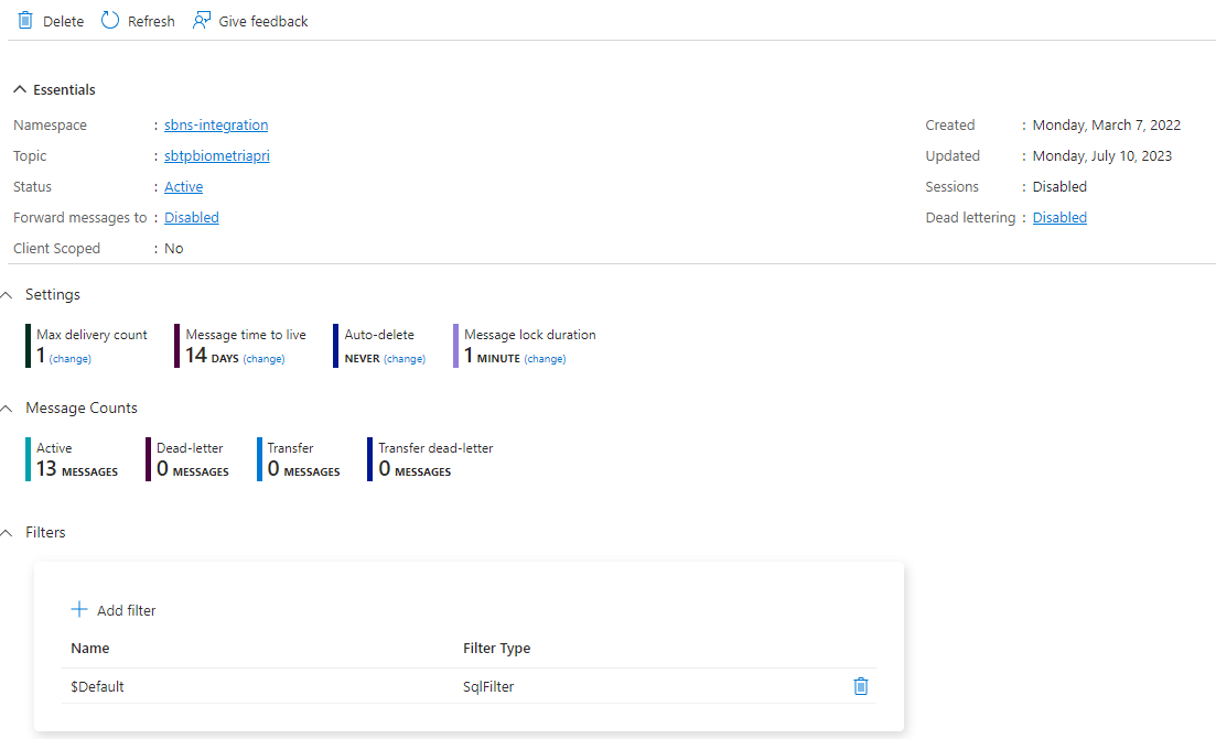

But its very strange that in the same topic, we are able to read/process messages from another subscription, with no issues at all. Below is snapshot of configuration for the topic
We are now helpless in this regard as, no auto forwarding is applied and even it processed few messages using Azure Function and then suddenly stopped.

    When you are using topic subscription then the message is always sent to the topic, but the messages are consumed from the subscriptions that are created under the topic and not from the topic itself.
    For more details you can refer to this document.
    So, if you have enabled auto forwarding on any of the subscriptions under the topic then you cannot use any application/receiver to receive the messages from that particular subscription. That is the reason you are able to consume the messages from another subscription on the same topic.
    You need to create another subscription with the same filter as your previous one so the new message can now be received from this new subscription.
