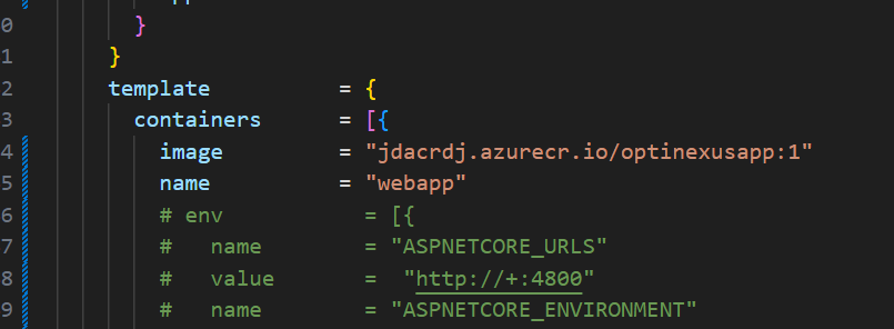

While using image from azure container registry in the container apps which we are deploying using modules approach in terraform, I am unable to use that image and this error pops up and I have also logged in through admin credentials in ACR then also this issue persists.
Screenshot 2023-07-18 175723
Error -->
RESPONSE 400: 400 Bad Request
│ ERROR CODE: InvalidParameterValueInContainerTemplate
│ "error": {
│ "code": "InvalidParameterValueInContainerTemplate",
│ "message": "The following field(s) are either invalid or missing. Field 'template.containers.webapp.image' is invalid with details: 'Invalid value: "jdacrdj.azurecr.io/optinexusapp:1": GET https:?scope=repository%3Aoptinexusapp%3Apull&service=jdacrdj.azurecr.io: UNAUTHORIZED: authentication required, visit https://aka.ms/acr/authorization for more information.

    I've found the solution to this issue. To do so, there must be set "User Assigned Identity", and configured repository access, see code below:
    resource "azurerm_container_app" "sampleapi" {
      name                         = "${local.prefix}-app"
      container_app_environment_id = azurerm_container_app_environment.app_env.id
      resource_group_name          = azurerm_resource_group.rg.name
      revision_mode                = "Single"
      identity {
        type = "SystemAssigned, UserAssigned"
        identity_ids = [azurerm_user_assigned_identity.ca_identity.id ]
      registry {
        identity = azurerm_user_assigned_identity.ca_identity.id
        server   = container_registry_host_name
    container_registry_host_name - {yourACRname}.azurecr.io
    Need to set AcrPull for this User Assigned Identity
    resource "azurerm_role_assignment" "acrpull_mi" {
      scope                = module.container_registry.id
      role_definition_name = "AcrPull"
      principal_id         = azurerm_user_assigned_identity.ca_identity.principal_id
    Using this setup I can download image from my Azure Container Registry using User Assigned Identity. Cheers!
