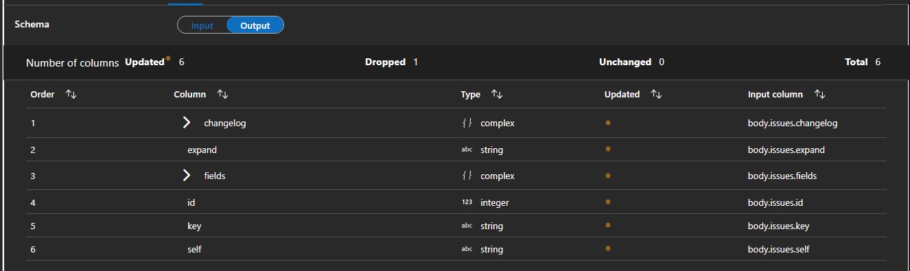

  • Changelog is a complex type: User's image
  • In the Sink, I allow schema drift and have the following settings set (I don't actually have an upsert condition listed in my alter row activity): Can you please provide me with some guidance on why I'm getting the error I'm getting?
Job failed due to reason: at Sink 'IssueDeltaLakeSink': cannot resolve 'source.`changelog`' due to data type mismatch: cannot cast struct<histories:array<struct<author:struct<accountId:string,accountType:string,active:boolean,avatarUrls:struct<16x16:string,24x24:string,32x32:string,48x48:string>,displayName:string,self:string,timeZone:string>,created:string,id:int,items:array<struct<field:string,fieldId:string,fieldtype:string,from:string,fromString:string,tmpFromAccountId:string,tmpToAccountId:string,to:string,toString:string>>>>,maxResults:smallint,startAt:boolean,total:smallint> to struct<histories:array<struct<author:struct<accountId:string,accountType:string,active:boolean,avatarUrls:struct<16x16:string,24x24:string,32x32:string,48x48:string>,displayName:string,self:string,timeZone:string>,created:string,id:int,items:array<struct<field:string,fieldId:string,fieldtype:string,from:string,fromString:string,tmpFromAccountId:string,tmpToAccountId:string,to:string,toString:string>>,historyMetadata:struct<activ

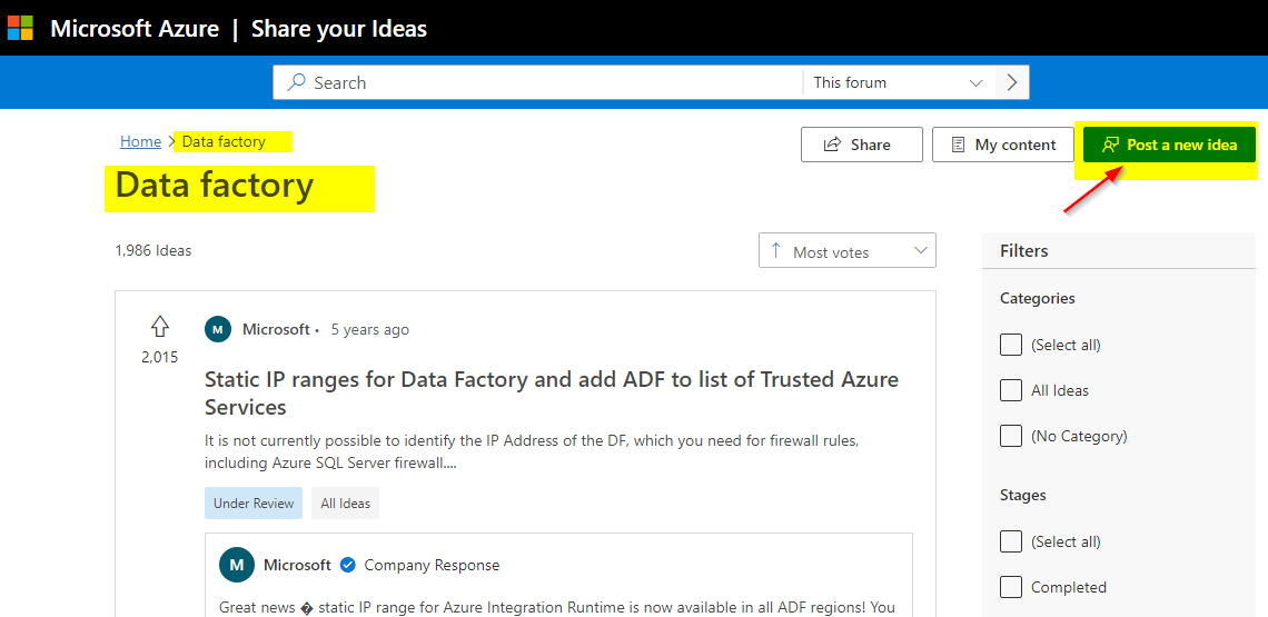

    Please Post an idea/feedback on the Microsoft IDEAS portal and we will be upvoting and others can comment, the Product team considers the feedbacks regularly and triage them.
