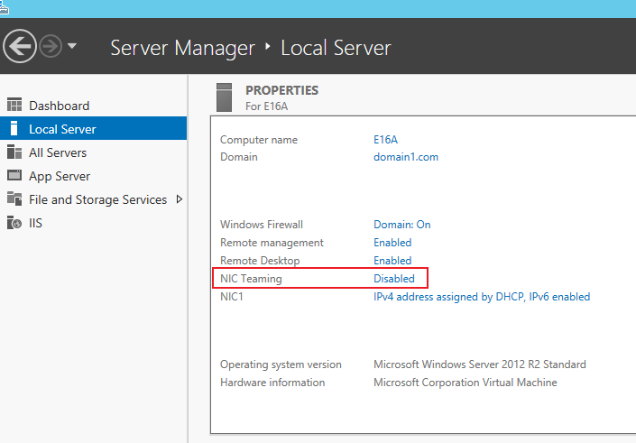

    If it doesn't help, please have a check if Nic Teaming is enabled on Exchange servers:
    01
    If NIC Teaming is enabled, please disable it to see if it can help.
